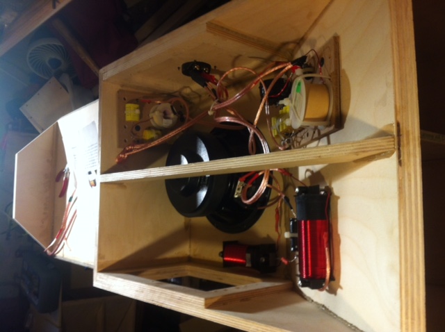

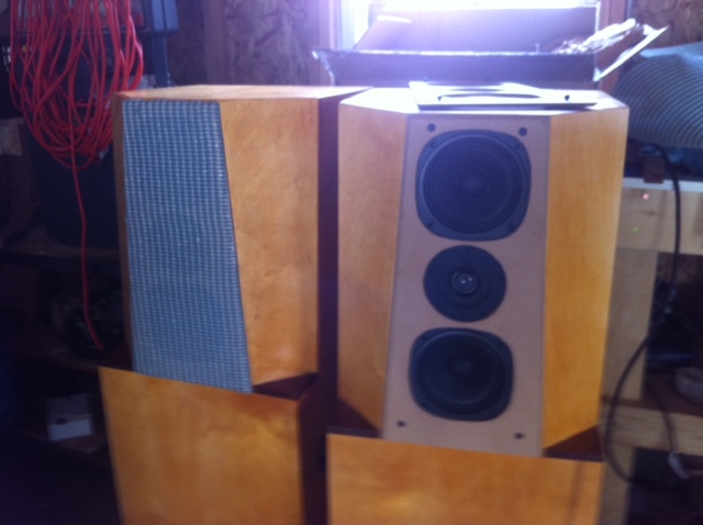

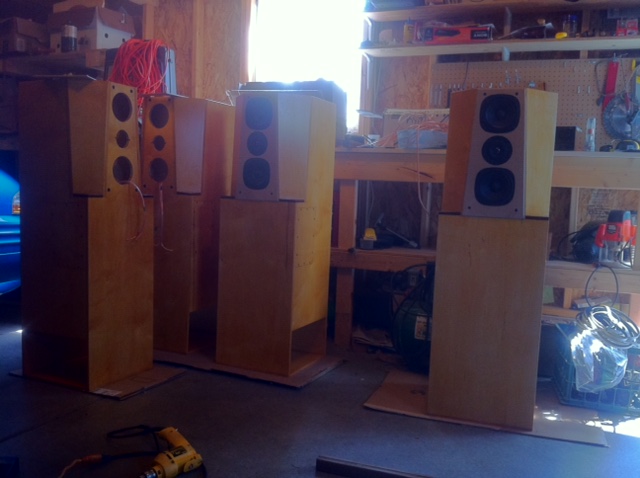

It took two years but I have now completed two pairs of davids.
The reason It took so long is that I paid a little too much attention to details.
I grooved the side panels with a router so that I could put the box together without fasteners.
I used a japanese saw that allows you to make plunge cuts with a thin kerf so that I could cut the access panels out of the sides and have a continous grain pattern.
I also dissolved shellac from buttons for the finish.
I learned alot in this project and I'm very happy with the sound.
I have never heard kick drum and cymbal clash so reallistically reproduced.

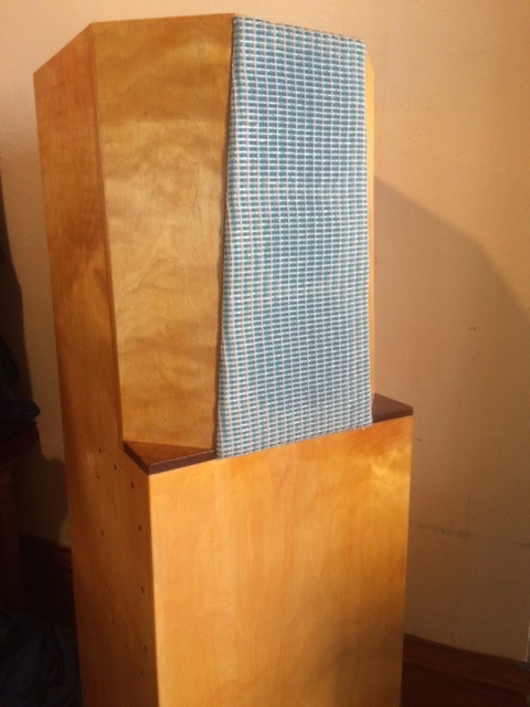

shrub0
Posts: 37
Joined: Thu Jun 07, 2012 10:32 pm
Re: 2 pairs of davids
#3 Post by shrub0 »
Its all Baltic birch except the walnut corner pieces. The shellac really brought out the texture of the wood.
