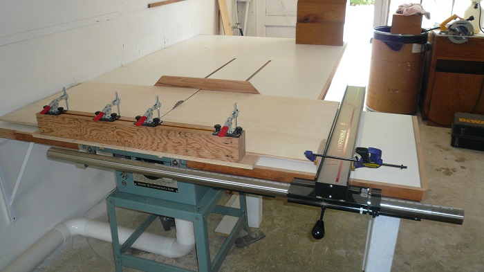

i turned a $150 delta contractor saw into an accurate tool with this aftermarket fence from Vega Pro. I can now cut 40"to the right of the blade with 8' of outfeed table making ripping 5x5 bb easy and safe. Worth every penny!
