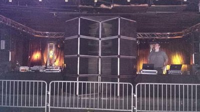

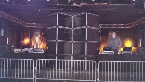

Had a chance to step back and take some pictures of the T36.
We were going to floor stack but for safety and attendance issues we moved them onto stage.
We were about 2ft off the floor and 2 ft from the ceiling.
8 Tuba36
2 Crown XTI 2000
we used the house sound side fill Jbls as OmniTop12 stands
2x2512 Melded
2xHO Melded
2xCompression Horn
2 x Crown XTI 1000
Tuba36 x 8
Tuba36 x 8
8 - Tuba36:24 wide 3015lf
4 - OmniTop12: Melded: DeltaliteII

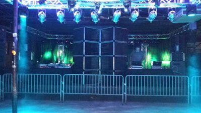

My close friend brought his compact 19 inch x32 mixer and EQ the room.
The x32 fixed some glaring balance issues.
cleaned up the eq and solved some problems at 350 hz.
The power alley was about 18 ft wide (I mean 12 ft wide) and 25 ft deep into the crowd.
there was a null at about 30 ft. (I noticed ceiling tiles were missing there?)
Then it was okay after 35 ft.
I think the ceiling is 12 ft tall.
The cook stated "you shook the dishes all night" with a smile.

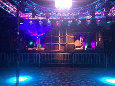

Dalton ran the Laser show from stage left, he is over 6 ft tall and stout.
I ran lights next to him and Dj was on stage right.

With that many T36's, do you really need a VPlate?!? :lol:
I may have been tempted to just have them in a line or do you start getting interference if the sub array is too wide?
Either way, looks nice! really nice!

Actually, no. Returns diminish as more cabs are added. With eight just the V coupling is adequate, the plate doesn't add any more to it.

At what height do you lose any advantage? My stack of T39s is right at 6 feet tall. Haven't every v-plated that configuration, but wonder if it's worth it should I ever have the opportunity.

thanks for the info!
Putting that V Plate on is tough, Ladder!

I wouldn't bother with the plate past 3 cabs high.

thanks for the positive words, I wish I could of cleaned out the horn path more... dust...

Well done!
Bill Fitzmaurice wrote:I wouldn't bother with the plate past 3 cabs high.
Regardless of width? Or is it a "total height" thing.
