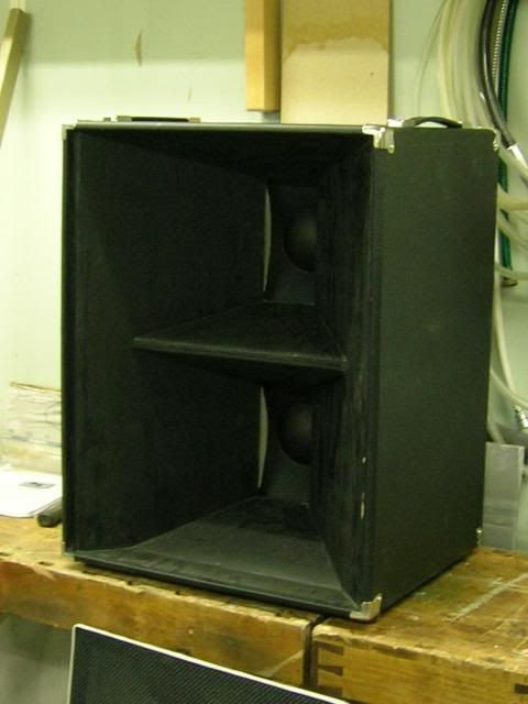

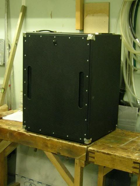

Here's few pics of my OmniTop12. It will be used as bass cabinet. Two Beta12's inside. So far I haven't tested it as I don't have bass amp right now. A tube amp with Alembic pre and Marshall JCM power section is under construction at the moment.

Some testing done. Sounds great! OTop12 is really efficient. 50W tube amp will be more than enough on the volumes I need. This cab really has vintage sound, only louder than those old cabinets.

bgavin wrote:When you say vintage, do you mean thin in the bottom?
There's nothing thin in the bottom with this setup. More likely the top end is a bit limited. But that's the way I wanted it, no fret noise or any other hissing and clanking. Sounds just like a BASS.

Great work Marko!!!!
What did you use to cover the cab and where did you get it? That is the exact look I am going for also.

Jujuman wrote:Great work Marko!!!!
Thanks
Michael
It's probably Tolex, but since Marko is in Finland his source probably won't be much use for you.

Yes, it's tolex.

Did you change the dimensions from the normal Omni Top212 18x22x28 ?

Tested today at rehearsal. Great! Very warm yet clear sounding with 50 tube watt, about 1/4 pre and 1/3 master this setup was loud enough to mix well together with drums and keyboards. And lows are no way thin. The cab was placed on the floor about one feet from wall and ports are facing to the wall.
