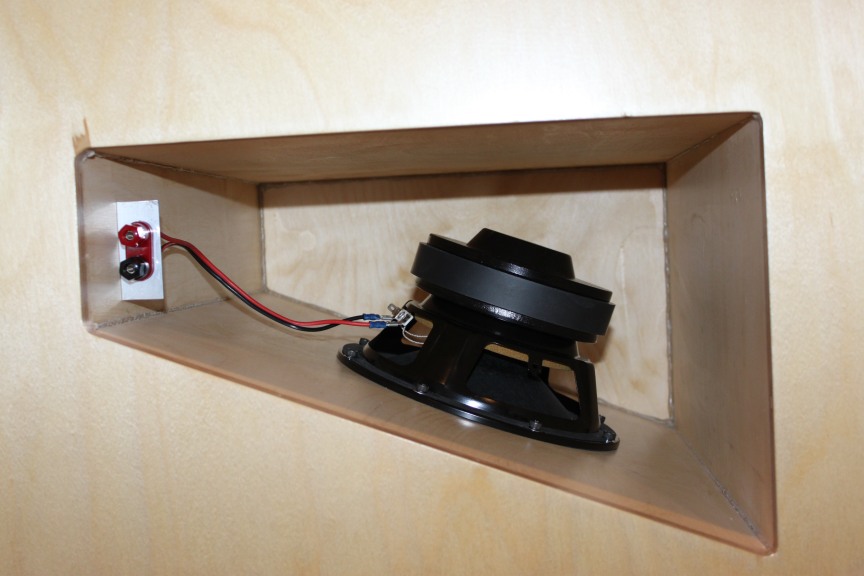

How does it work without the chamber opening closed? Is that a piece of clear plexiglass or something.
Re: Yet Another Table Tuba Build
#10 Post by Grant Bunter »
johns811 wrote:How does it work without the chamber opening closed? Is that a piece of clear plexiglass or something.
As for the lack of a cover over the access, most bass horns seal the rear chamber to tune the cabinet response and apply restorative force to limit the excursion of the driver. The Table Tuba horn is long enough so that the air mass of the horn alone will tune the driver response and limit excursion. Excursion above 15Hz is unaffected by the lack of a cover. Moreover, the open chamber is a second sound source at very low frequencies, similar to the port of a bass reflex cab. To preserve the tuning of the cabinet the side with the access hole should be 1½ to 2 inches away from the boundary, be it a wall or floor. If you lay the cab on the floor use legs to lift it 1½ to 2 inches.

Very nice clean build and finish.
Hope you're enjoying it :)
Thanks, I only built the T24 and a cover was mandatory. It thought they all needed covers.
