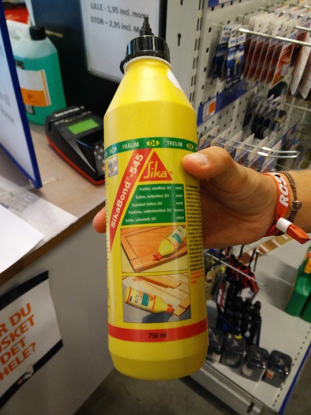

In europe it's almost impossible to get your hands on Loctite PL Premium if you don't import it from the US. Since import VAT and fees are crazy in Denmark we searched wide and far (even on this forum it was hard to find real alternatives mentioned) and found this SIKA PU glue. It's doing the job great! It's 100% Polyurethane, expands quite a bit and cures in about three hours - and is made for gluing wood.
Hope this can help others who are maybe desperate in europe :wink:

This is the glue we found (on the picture). It needs moisture to cure, so you have to spray it with water before attaching the part you want to glue on - seems kind of counterintuitive to make something wet in order for it to dry :mrgreen: .
And by the way - since it's important to mention your mistakes here - it's a good idea to wrap your jig in plastic or something... Took quite a bit of muscle to get it off after a good nights drying and curing (we left it like picture 2 above).

Third Sika has been successfully used by forum members. :clap:

Hey Bill - yeah we read that, but of course thought we could just "knock it off" if it stuck. Maybe some part of us even wanted to see how good the glue really was :) Good enough! No harm done though, and we will definitely stick to the plans from now on. Thanks!
Tom: Thanks! Cool with the SIKA - good to know. I couldn't find anything stating that any specific glue other than PL worked for sure, but now we know :)

Sika do a number of polyurethane adhesives but I don't recall seeing one not in a cartridge/tube (is that the correct description?)

Chris_Allen wrote:Sika do a number of polyurethane adhesives but I don't recall seeing one not in a cartridge/tube (is that the correct description?)
We actually tried to get this in a cartridge/tube/'gunmountable enclosure', but they only had this. Works fine though :cowboy:

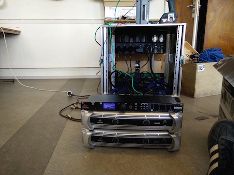

We also got a amprack together. We decided to go for the iNUKE NU6000 amps after researching a lot - they just seem to be really good bang for the buck when you're not exactly swimming in money. 3 of these should be able to power 8 Titans and (at least) 4 OmniTops.
So of course we tested out the one finished Titan - damn that thing is LOUD! By the looks of it it easily plays as loud as our two HK Linear 5 2000 Subs, which is at least double or triple the price (and power consumption) EACH!
And it sounds great too! We could not be happier :fruit:
