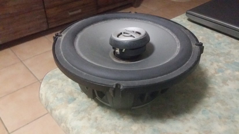

Hi guys,
I have had these speakers in storage for some time now and wanted to put them in my man space for some tunes. Now then only issue is, I am unable to find the external crossover that they came with. As the mid and high are separate, I am unable to use them.
I was wondering if anyone on here would be able to help me out with advice on how I could make a simple crossover to get them working again?
I will be just putting them into a box with an old sony headunit I have and powering it with my bench power supply.
I have attached all the details I have on these speakers.

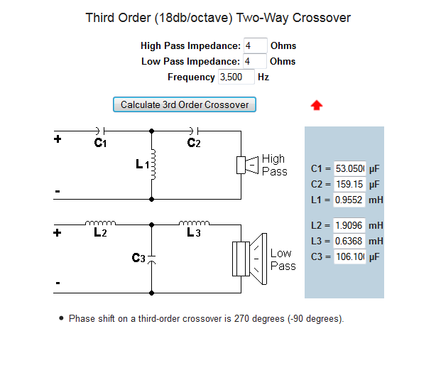

I thought to myself, if I brew my own beer and fix and tinker with my kids toys. I might as well make my own crossover. However, as I have no clue. I punched in the following from the information I know and got the following.
Would this work? Also, what is the phase shift message mean down the bottom?

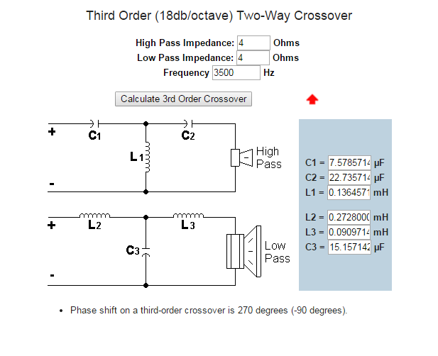

A calculated crossover will work, but not perfectly, as it assumes the driver impedance at the crossover frequency to be exactly 4 ohms, which it will not. But without impedance charts of the drivers it's the best you can do. The phase shift doesn't matter when it's not 180 degrees.
That chart is odd, the values are off by a mile. C1 should be around 7.5uF, C2 22uF, C3 15uf. L1 should be 0.14mH, L2 0.27mH, L3 0.1mH.

It looks like that program calculated for 3.5Hz, not 3500 Hz (I can see the decimal point)
But that wouldn't make sense either - the values are not off by 1000...

Hi Gents,
Looks like it was a mistake on my behalf. Thanks for the reply's also.
It in fact was a full stop and not a comma. I have removed it and just had a direct input of 3500. Now I have something that looks correct.
