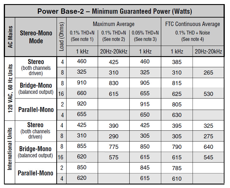

Hello all,
I have an old Crown Power Base 2 amp will be creating a new PA system for DJ use. I will be mostly using this system for small weddings and small events.
Pair of rectangular TLAH. Each with 8 or 9 Goldwood GW-4028/S and 12 Goldwood GT-302/S. Maybe you guys can help with deciding between 8 or 9 woofers
Pair of Tuba18's with Tangband w8-740
Will my Amp suffice?

Re: Crown Power Base 2 for Pair TLAH and Pair of Tuba18
Hi there,
Intrigued with your thoughts regarding cab selection.
The sales page suggests TLAH is perhaps better suited to installs than portable use. I think a lot of people would probably suggest the SLA pro.
Similarly, the T18 is designed for home use, where it will benefit from room gain, say in small home theatre.
With no setting of high pass etc (ie not for "pro" use) I would be leery of using that cab in a semi pro situation, driving it to hard, and blowing the driver(s).
Equipment failure (for whatever reason) will hurt your business.
So you perhaps need to be looking at at least the T24 with, say, BP102 drivers given your amp output.
I understand your choices may have been made on what you plan to carry the system in vehicle wise, but better to choose the correct cabs for the job at hand...
The most power that you would want to put in a 9-driver TLAH would be 120w. Same for the T18/TBdriver. Having said that, you would need a hard-knee limiter in front of your amp.
Is this to be a multi-purpose build, ie, for HT and small PA?

+2. If you're doing pro sound you need pro sound cabs. Even the smallest venue is at least four times the size of the largest living room.Tom Smit wrote:+1 to Grant's advice.

Thank you very much for the reply guys
My choices on the tlah and the tuba 18 were basically due to convenience and to not having a truck anymore. Currently driving a 2013 accord.
I've long sold my dr200's which were my favorite but I don't think I have the patience or time to build those myself again.
I've also sold my omni12's which were great too and I may just build a pair again since the tlah's aren't recommended. I think I may be able to stack a pair of omni12's in my backseat.
As for the tubas, I've made a pair of tuba 30's, 20-24 wide if i rememeber correctly, that were just way over kill for the gigs that I actually needed to bring a PA system. Even bringing along 1 was a hassle. I remember bringing my autotuba to smaller gigs that sounded nice to me. And I do have an unused w8 740 I purchased a long time ago to load into my autotuba but the McM sounded just fine. Which Is why I had the tuba 18's in mind
Since now I'm in a smaller apt I was thinking of making the tlah and use them for HT use and bring them along for wedding gigs. Dont really have the room for big cabs to stock. The majority of my gigs are at a bar or club where there is a house PA system and I just bring my laptop.
I have a 5 weddings so far this summer starting the end of may which Is why I'm planning to make some cabs instead of borrowing/renting some powered mackies from friends.
Do you guys think this crown amp can handle a pair of omni12's (deltalite 2512) and a single T24?

Arrr things have become clearer lol
At least you already know you need to brick wall limit.
If it was me, I would build the TLAH's and leave them on the wall at home.
If a T30 and Otops 12's were way overkill, I can now see where you're coming from.
The 3012lf only fits from a T30 or T39 and up. Sell what you have to fund your latest build.
The latest plans for the T24 include the now newish 3010lf, with a voltage limit of 55V IIRC, way above your amps output capability.
What you could do, and would be within your amps capability, would be to build a single T24 with BP 102 (limit 35V) and 2 half size SLA pros. That would require the small SLA's to run in mono. The 2 half size SLA's could then double as surrounds at home, and the sub could also be used at home. That system should be adequate for your DJing needs, and really, can't get any smaller.
In output terms, a pair of Otops are going to way overun any single of the smaller subs, be it autotuba (which I wouldn't use anyway in DJing), T18, or T24.

Ive just finished reading Lelands Sticky on testing the voltage Output and wanted to test This Crown Powerbase 2 amp.
Wondering if you guys can Check my work.

Did i do an accurate test? was it ok to use these videos from youtube?

Start over. Forget youtube for tones. Load audacity on your computer and create the tones there.
Turn everything off on your board relating to crossovers, limiters, feedback destroyer, or anything else. You want the pure signal with no processing. Use a mono out if there is one.
Crown has always been good about their numbers. Why are you testing the output? You can take the stated wattage and plug it into a calculator to give you the voltage.
According to the manual, this amp puts out 325 watts at 8 ohms. That's 51 volts.

2 things in your 200Hz test:
1) You have the xover set at 200Hz, so that means that it will be down by either 3dB or 6dB at the xover point. The 2 possible values (3 or 6dB) is because it depends on the type of crossover on the DDM (Butterworth/Bessel/etc or LR). I own a DDM4k also and have never found out what sort of crossover is in the units (I think I did find out that it is 12dB/oct though).
2) You only have the output set to -2dB on the 2nd test also. It is PEAKING at ~0dB, but your RMS output is -2dB
