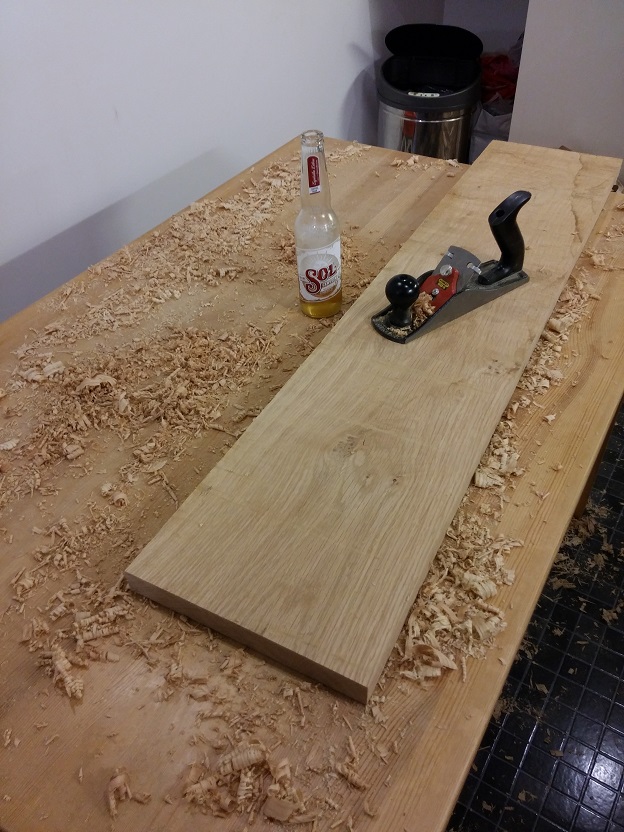

Got some nice oak I tried hand planning....
Not too bad finish but not flat.  In the end I faced off in the CNC - something I should have done to start
