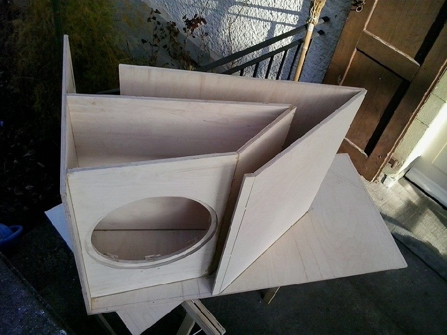

As already threatened, i will show you my building process. First i start with the T48.
First i want to thank for the recomendations i got on this forum. (In this thread: http://billfitzmaurice.info/forum/viewt ... 28&t=22072)
So i got my wood, my speakers, all wires, etc.
I allready made the cutouts and finished the speaker mounting panel.

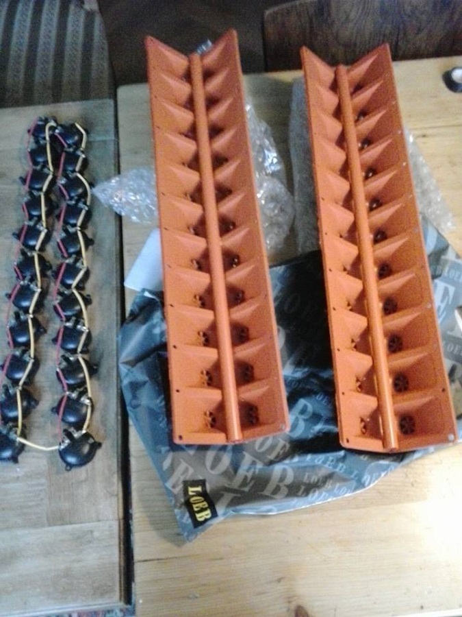

Yes on the Dr's will get the HF section, colored the same way. The Black is the RAL Code 9005 (Deep Black) silk glossy, the orange is a MTN Mars orange. It isn't as pale as on the picture (shitty cellphone cam), its slightly darker.
Here ist the color:
Actually its just a grafitti can, but it behaves really good, dries well, and if you use one of those "astro-fat-caps" you won't have to struggle with running paint (don't know the right english expression but you know those drops).
It also doesn't peel off or something like this.
Actually i frist wantet to paint the cabs in a dark grey, but as the Plastic corners and the jackplates are black i, just took black for convinience reasons. But i still wanted to give it something special. It should have a slight touch of some strange outerspace vehicle. Even if the combination forces some "eye-cancer" its not that common black in black.
Here ist the color:
- Chris_Allen
- Posts: 3358
- Location: Huddersfield, UK
Re: T48 Build
How can you not love the piezo array? Especially when it's orange!
