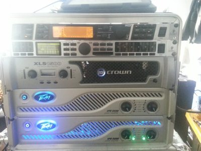

So, my band's turn was Saturday afternoon. The rig was 2 OT 12's, 2 T39's plated all run off 1 Peavey IPR 5000 via a Driverack. I used my Behringer V-verb Pro with a bit of reverb and some delay to add feel of being in a stadium. I ran 4 monitor feeds. The drums were mic'd and the high hat. The Leslie has 2 mics on it. The Yamaha piano is DI'd. The 2 guitars run via Radial JDX's DI's and the bass was via his line out. 4 vocal mics, one doubles for harmonica. All through an A & H GL2400 board.
New to me for these past 2 outings is the A & H board having a 4 band EQ section vs 3, running 4 monitors (had been using 2 ear feeds), feeding the bass through the system and running 3 amps. After dialing in the Driverack EQ using a few recorded tunes I had about 30 (I think) minutes to get all the mics set and everyone's volume on their monitors set while trying to figure out why something that should be happening wasn't. Like why my effect was not showing it was getting a signal and why the main/subs had no sound. The amp was off!

Looks like my rig, down to the same amp rack and a pair of Peavey IPR amps.
Sounds very nice. Good Job.

dswpro wrote:Looks like my rig, down to the same amp rack and a pair of Peavey IPR amps.
Ah yes. I just need to fill my last spot with one more amp. I'm thinking another IPR1600 to run the monitors. Then when I build 1 more set of speakers I'll be all set. Run the tops off the 3000 and the subs off the 5000. If needed. :wink:
