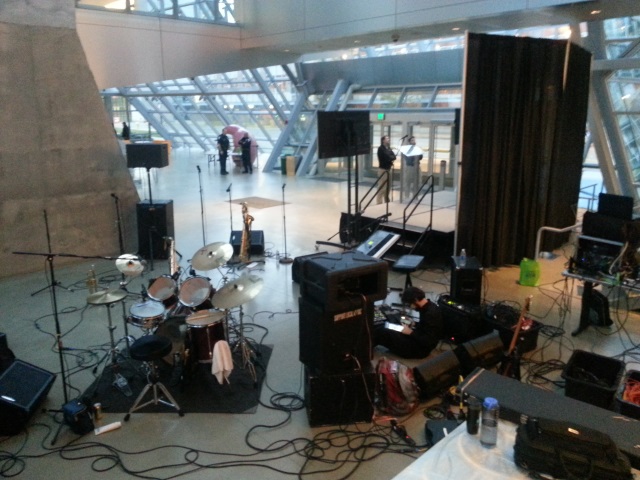

You should come hear my Otop 12's some time. I'm in Medina but use them frequently in Akron / Canton. I've 2 melded and 2 with the wood horn and Selenium drivers. ( Which I prefer) PM Me of you want to get together some time.
Don Sullivan
Akron Art Museum set up for Get On Up
