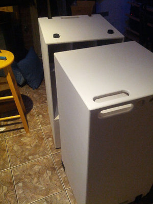

More painting and sanding. Three coats starts to look pretty smooth, although you can still see some pencil lines though it.
Re-installed the wheels and installed the feet since I'm willing to call the bottom white enough!

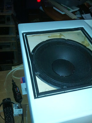

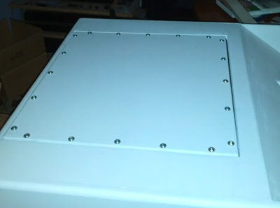

Fourth coat of primer on the access panel and it's ready to install.
Measured out and drilled the holes with the panel in place, then removed it to vaccum and apply two strips of gasket tape running on either side of the holes.
1-1/4" Kreig screws added and it's in place! Only one slightly spintered edge, not bad enough to worry about. I love the pre-washered heads on those screws.
Speakons soldered on, and I was able to test it out...no leaks, no rattles. Next is scewing them in---it's really tight in there so I soldered the wires on sideways so hopefully they'll fit.

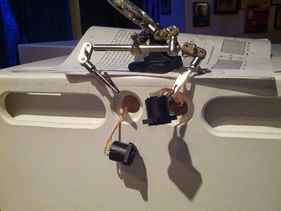

#36 Post by whines »
Speakon jacks screwed in--they fit fine, and I'm quite happy with my decision to use a 1/2" backer and screws rather than 1/4" and bolts. Much less of a PITA.

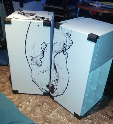

All corners and slide rails attached, so it's decoration time! Getting busy with markers.
Once this is all done I'll get a pic of the whole stack assembled!

#37 Post by whines »

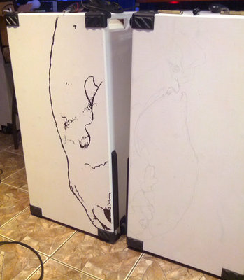

Side decoration finished.
