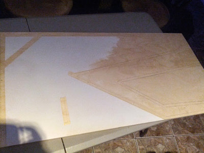

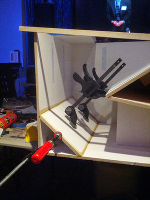

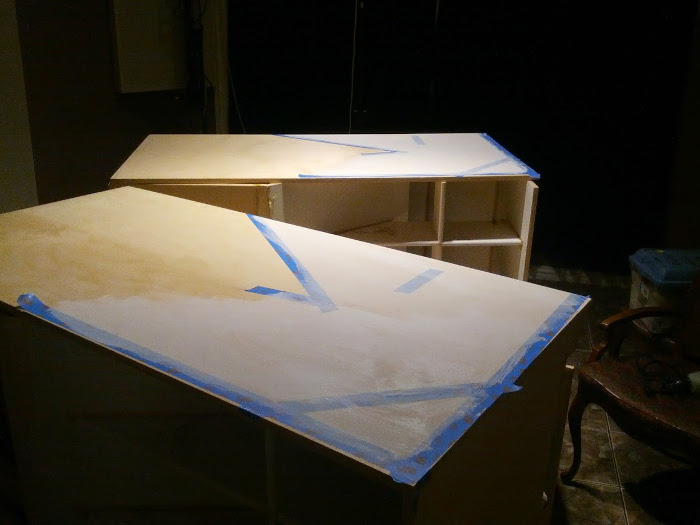

Got two layers of paint in the mouth after putting tape down to keep the to-be-glued areas clean. It's annoying how far you can see up there if you look at JUST the right angle. :J One more coat and I'll call it good.
The mouth braces are now assembled...and then I remember that I forgot to put handholds in them. Dangit! I -should- just put handholds in the edge, and it's not too late to do that, I just don't like the way it looks. Which is silly, but. Hmm.

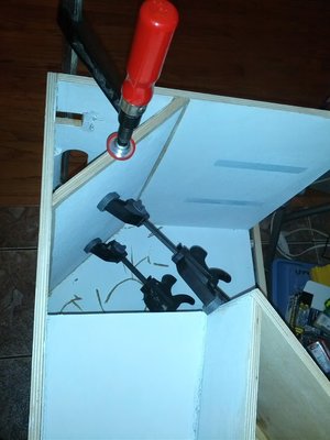

Panel 11 installed on one sub. I didn't realize you could turn the clamps around like that until I saw someone do that in a build log, very handy!

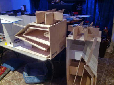

Second panel 11 installed, PL scraped.

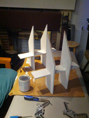

Mouth braces scraped and sanded, given the first coat of paint. Eventually I realized that they'd stand up on their own, started getting less paint on my hands at that point. :)

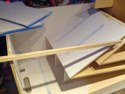

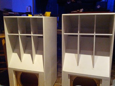

Used bondo to fill in the center of the braces, used a file to get it in the right shape (thanks to whoever mentioned that!) and sanded it down. Two applications of bondo would have made it perfect, but...it's going to be facing the wall. :)

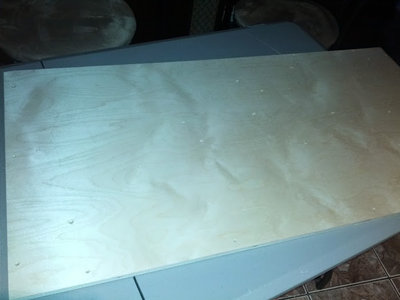

Cut the final side 1/2" large, matched the nice edge up with the open side and used a pencil to mark all the parts I could reach. Covered joints-to-be with masking tape in the mouth area and prepainted it, two layers of Kilz.
Drilled some holes along the boards I'd marked, test fit it and predrilled holes for the screws to fit in. On the corners I left the screws in, poking out just far enough to settle in the holes for alignment.
Put a good bead of glue on the edges, got my partner to help me set them in place and they're on!

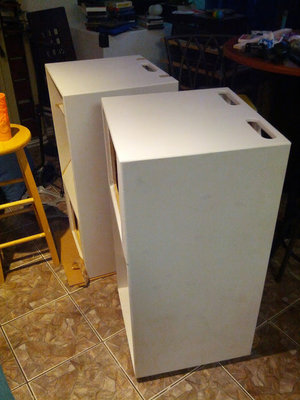

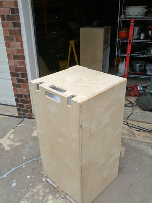

Lots of time for working on these babies over the three day weekend, even with goofing off thrown in!

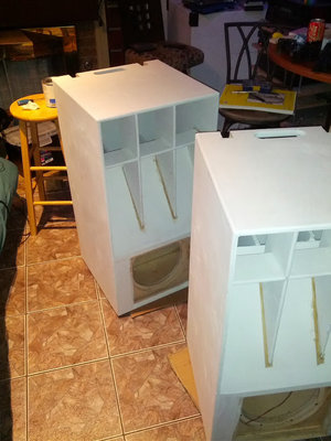

After a day of drying, took the screws out and trimmed the second side, then did a roundover on all the edges.
Let the drivers burn in with 35hz at 10 volts for half a day, wired out of phase so they were pretty quiet.
Bondo'd the screw holes, sanded, bondo again, sanded. Then first coat of paint. Inside, thank goodness, Texas is still too hot.
Used chisel to scrape the remaining PL away from the braces and other crevices in the mouth, sanded it down some, and gave it (and the outside) a second coat of paint.
Got of of those folding dollies from Harbor Freight for moving them around between the driveway for sanding and the living room for painting--I like it a lot (the big-ish wheels go over bumps great) but the black plastic leaves marks on the pristine white paint. Guh. For now I'll cover it with cardboard, but I need to treat these with kid gloves until I can get a protective coat of glossy acrylic on them.
I need to get the drivers in to leak test before I get any crazier with the finishing...

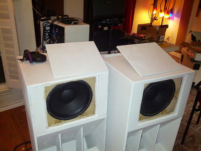

A little more sanding, a little more paint, and the last cuts of the build to make the access panels!
Leak tested (sans panels so far) and everything seems good.
