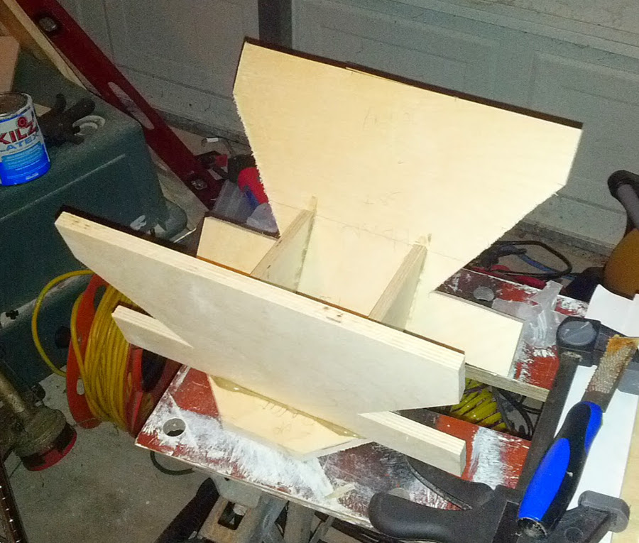

I run a kareoke event occasionally and figured that giving the vocalist the ability to hear how his or her mic holding is sounding is a good idea. (no amount of gesticulation on my part seems to do any good when they decide to hold it so no one can hear them)
Also, the W6 looks really cute and I had a fair amount of BB left over from the SLA's. So I ordered a kit from Leland and got started.
This weekend most of the parts got cut and the first few panels were glued!

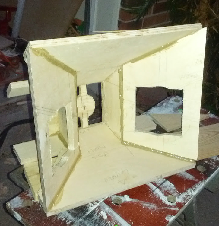

Wow, impressively bad job on the mouth panels. I cut them way too tall--which is at least correctable--and then overcompensated and made them too small. Within the bounds of what PL can deal with, though, so I went ahead and gooped it on. I'll have to add a bit more in a few places, depending on how much it expands.
Used brads to hold the very wobbly panels in place, and tacked in scraps of wood behind them. (not visible)
- Chris_Allen

That looks less than 1/2" out - I made cutting errors way bigger than that!

Thanks, Chris, that's reassuring.

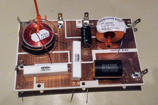

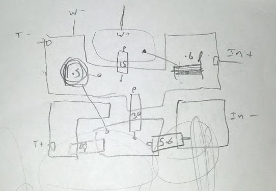

...whoops, the right inductor shouldn't be hooked up to In -. Glad I didn't solder yet!

It looks like your 0.6mH has .53 ohms resistance. That's above spec. It will work, but will cost you some sensitivity. OTOH the 0.5mH appears to be a larger gauge than required. No worries, but a smaller gauge would cost less.
Re: W6 build
18AWG inductor ordered. Thanks for catching that.

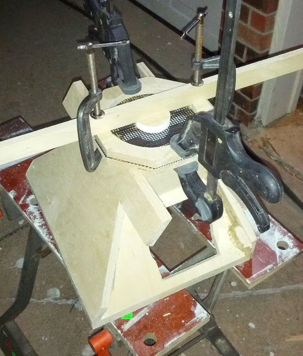

Crossover soldered and glued down (although I'll be taking off that inductor) and I cut the horn to fit in the shell. Eugh, that top section...my angles were not great on the horn top and bottom. Mental note: Get them closer next time. Hopefully close enough though.
Next: Track down some pet screen, do a little sanding and paint parts that are gonna be hard to reach later!
