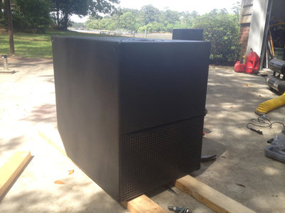

in my opinion, it would be worth it to install proper grilles with acoustic foam on your gear now.
I like this grille material, and being 30" tall means it will fit the t30s nicely
http://www.parts-express.com/flat-metal ... x-30--262-
back it with some acoustic foam (which is likely cheaper sourced from somewhere other than Parts express and you are good to go.
Heres a pic of that flat grille installed on one of my other subs.
