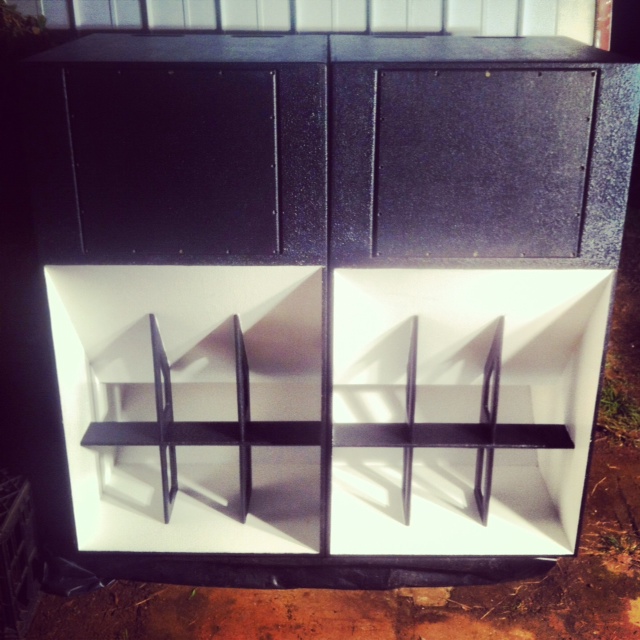

Got 2 completed the other day- just working on the V plate for the pair now!

V plate done, sits nicely and looks good, now onto pair two.

Thanks for the kind words folks! I'm pretty happy with how they both turned out- no major issues in the whole build so far. They both sit nicely next to each other- square, same height, parallel lines etc- I'm sure my dad would be proud (if they were not boxes designed to play my infernal robot music). Going to hook them up and give them a burl tomorrow (using normal hifi floorstanders to provide the mids and highs as we are still working on the rest of the system). Will get a pic with the V plate and maybe get a vid to show shitty phone mic quality bass fuzz for you all- but what else can you do?
Got to fix a few dodgy t nuts on the next set of driver anchors before we get stuck into making their twins. That and some synergy horn experimentation is next on our list of things to do.

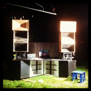

Bit of a hiatus from us here in chilly Canberra. Had a few mornings of -6/-7 degrees that have been painful to get through but we have been plugging away at it all on the nicer weekend weather. A few nights huddled under the warming glow of 1000 watts of halogen lamps has kept the progress moving mid week too.

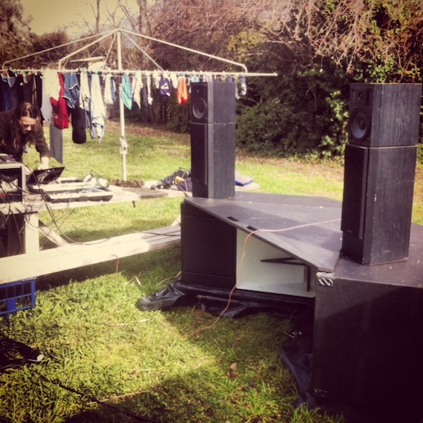

So we have 2 15" Ande loaded 25" wide titan 48s complete with a v plate that we got to test out 2 weekends ago. With only some Hifi floorstanders doing mids and tops duty we got them all hooked up and thumping. No noticeable air leaks around the access cover and everything seemed pretty good. Only ended up sending about 30v of the potential 60v to them (we were still waiting on a beefier amp at this stage). They were sounding really good but we couldn't push them any harder without flooring the amp or outstripping the tops. I went for a walk around the front of the house and about 40 meters down the street and they still had a lot of clarity and carry. It was really satisfying to finally have a bit of an idea of what we were achieving with the project and it was a shame that all the motivation and energy was quickly met with the demands of another working week

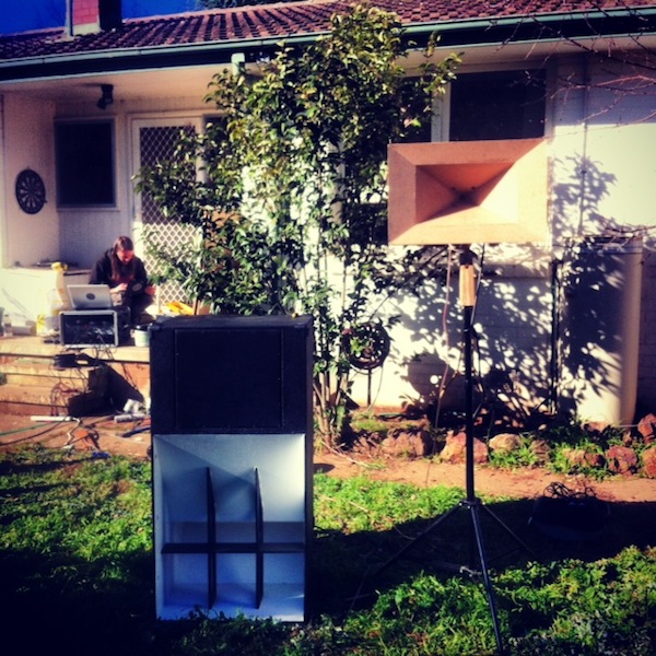

In the meantime- on a spur of the moment retail therapy moment on a mid week, cold winter night, Horizonize goes out and buys all the kit for a set of synergy horns so we shift gears and start reading up on that caper. its an attractive option because of the quick build time, the inherent qualities of the design, and the fact that we already have some w bins that we can restore to get a full system up and running quicker than building a pair of DRs.
So this past weekend we bang out a prototype of the synergy horn and set it up with a solo titan for a bit of a play. Yes there is a pretty big gap in the system as it was with no dedicated driver for the mids and our crossover setting was asking a lot of both speakers but we were really impressed with the clarity and dispersion from the horn and are looking forward to having a chance to dial it in when we have more time and more completed cabs.
Fast forward to this week and 2 18sound 15s arrive in the mail for our w bins, and we now have a QSC amp capable of getting all 4 titans to the 60v limit. Hopefully we will be able to make another matching synergy prototype and mod the w bins to fit the new drivers in time for the weekend so we can have a good play with the eq on what is almost a complete system (well, minus the other two t48s that are all cut but yet to be assembled!

Had a big day today finishing off the 2nd synergy horn and getting the W bins ready to accept the new drivers. Got them all set up and after a few false starts (still figuring out the processor/limiter/crossovers atm) got them all working nicely together. Could not do the Auto EQ because we didn't have the right cable for the Mic- so everything was by ear on a few of our favorite reference tracks. We were really liking it- the windows in my house that were buzzing were not...
They sound the business...now we just need to make them look that way too. Some more bracing for the W bins and a few coats of paint are definitely in order.
