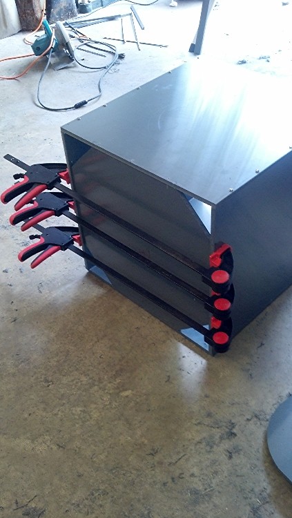

A box is formed!
Front baffle installed.
. . and from the back.

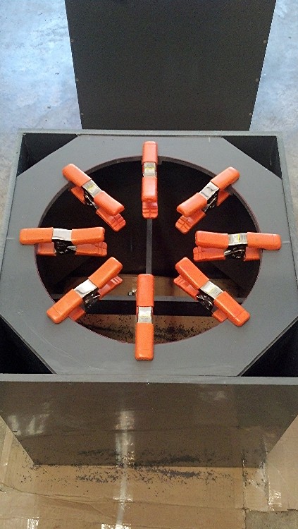

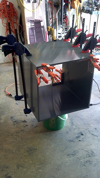

The port ducts being glued and pressed into place . .love me clamps! :lol:

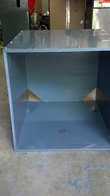

Shot showing the entrails and the grill extensions on the front outside.
The next three showing better detail of the grill extensions and test fitting the driver.
