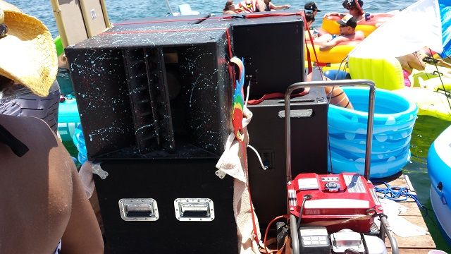

Okay, so as of now, I have 2 double loaded T30s being driven off one channel of a Peavey ipr2 3000, 2 Otop12s being driven off on side of the QSC USA400 (about 200 watts into 4 ohms). The subs will be stood upright and side-by-side with the Otops sitting on top of them. All of these will be facing "front" or "rear" of the raft so as to not kill any raft passengers with sound. I am strongly considering adding my Jack12 (driven off 2nd channel of qsc amp) facing the raft itself so the passengers will get some sound too.
Any thoughts? My concerns are not having the tops high enough - sitting on top of 30" high subs on the raft that will probably be sitting at least 1 foot above the water level. Most "rafts" will be inner tube type floats, but there probably will be some other pontoon type rafts too. Should I consider raising the tops? I have some cheap tripod type speaker stands, but not top hats installed in any of my tops - just the plastic hats that screw onto the bottom of the speakers. Of course stability is a concern with these being on a raft!
I think we will end up splaying the tops about 90 degrees for wider coverage. Of course if I splayed them 120 degrees we could theoretically get all 360 degrees around us. All tops have melded arrays, so I may do the 120 degree splay.

Also, the generator test running all subs (but only 1 otop) went perfect. The generator is not too loud either. The weather forecast says 110 degrees Saturday! Yikes. The water temperature will probably be "only" in the 80s. I am planning to put a light sheet over the amp rack in case any water is splashed onto it. Hopefully the amps can keep their cool.

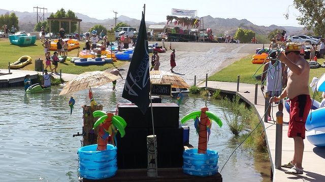

The Raft:
Don't mind the fat ass holding the rope in the pic (me). I swear I don't have a "good" side anymore. You can see my tiki redneck margarita machine on the left side of the raft, along with the 2 otop12s and 2 dual loaded T30s. And my cool tiki we screwed to the front.

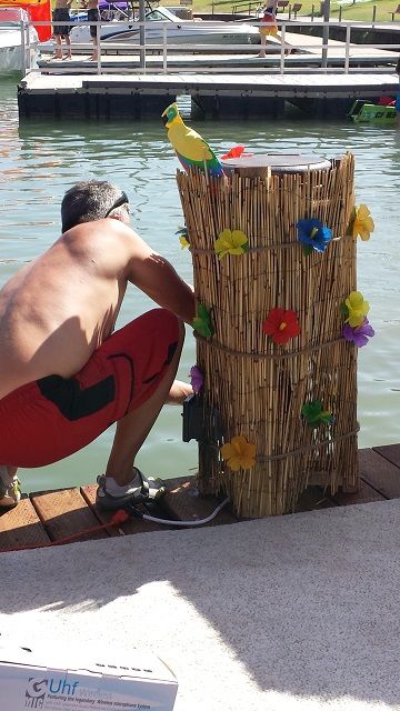

Another shot of the margarita machine (Lowe's 5 gallon Igloo cooler with garbage disposal mounted on the bottom, then wrapped with reeds)and a few of the party people

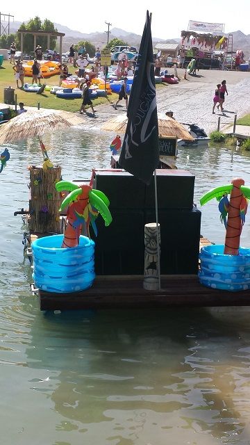

Some details on the raft, etc.
The raft was built as 2 8x8 rafts using pressure treated 2x6s. Each raft was set on 4 55 gallon plastic barrels which float about 450 pounds each. The 2 rafts were bolted together to make a single 8x16 raft, but the waves caused the 2 rafts to flex at the bolts and started pulling the wood apart, so we just used nylon tie downs to hold the rafts together but allowed them to flex in the middle. If too many people were in the middle of the 2 rafts, the seam there would dip into the water so we had to scatter the people around the raft a bit. My amp rack had the front and back access covers off but I stapled cheap towels over them just in case we got hit with water - there were a lot of people squirting everyone with water. I did put a little 8-10" fan in the back of the rack to help circulate air just in case the amps needed it.
The margarita machine with the 1/3 horsepower disposal drew a shit-ton of power on start up which caused the music to die out completely for about 5 seconds. Also the generator would jump around when I flipped the switch for the disposal. I am sure that wasn't the best situation for the amps, generator, etc. but everything worked perfect after the disposal was up and running. I may want to add a battery setup or capacitor for the starting of the margarita machine. It was funny when we asked if anyone wanted a drink from the margarita machine. People would swim up and (with the machine running, mind you) we would open the 1" ball valve above their mouth and they would get literally showered with margarita. A disposal and a 1" pipe = a lot of margarita real fast.
Speaking of the margarita machine, it works amazing in the garage, but in 110 degree weather using ice that is right at 32 degrees instead of the 0 degrees right from the freezer, we did not create slush but rather really cold liquid margaritas. Gotta come up with a solution for that.
