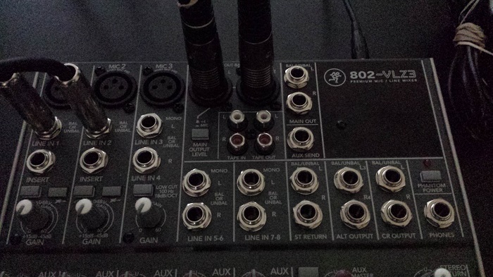

I run a Mackie 802 VLZ3 and it's got xlr to the driverack. During my testing, I was using unbalanced TS, but that shouldn't matter to the driverack because I increase the master volume on the mackie to compensate. The switch on the back of the driverack is set to +4dbu, and the other option is -10dbV. I assume that's a pad? What's the difference between the dbu and dbV?

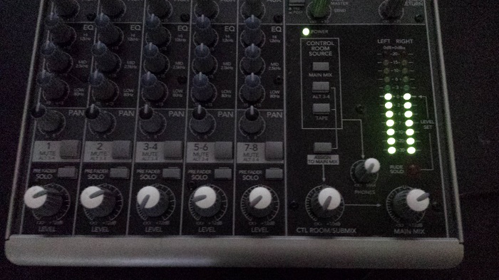

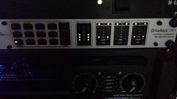

I tried setting the back to -10dbv, but no matter what I did, I couldn't boost the (60hz) signal enough to clip or even get close. I assume +4 would be correct then. I also tried using the Mic setting on the master level on the mixer, and that also had me cranking all the pots and not getting it to clip.
This is what I get with the normal settings, back at +4dbu and main switch at +4 instead of Mic. This is into HARD clipping, it starts going red at 4 on the mixer meter.

You are kinda' mixing and matching levels and cables.
Use the XLR outs on the Mackie. Set the output button to +4.
Use the XLR inputs on the DR. Set the button to +4
Use XLR cables from the DR to the amp.
In the DR, go to the crossover section and see if the output of the subs and/or tops is set to -0-.
In the DR, check both the PEQ and GEQ settings, is something goosed really high?
See if that clears it up.

I have all of those cables you listed already set up, the only thing I have that's different are the cables into the channels on the Mackie are TS.
I don't see any clipping anywhere on those pictures, in fact everything looks normal. What I do see is red lights above the low output section on the driverack. Those red lights mean that the limiter has kicked in. Lower your output gain in the x-over section for your lows until the red lights come on at 0dB, then adjust your tops output gain to match.
Ah, my mistake, I didn't mean clipping, even though I said it a bunch of times :slap: I see red and the word "clip" comes into my head :lol:
I will give this a shot, but this won't affect how my Mackie mixer triggers the limiter at under -4- instead of -0- right? I guess if my previous hyphothesis is correct, that won't be an issue! Thanks for the advice, I'll check out the xover gains on lunch!

Faux127 wrote: I will give this a shot, but this won't affect how my Mackie mixer triggers the limiter at under -4- instead of -0- right?
By adjusting the output gains on the crossover you can set the driverack to show red wherever you like on the Mackie mixer. Put the mixer where you want it to show red, then adjust the crossover gains until it does.

Great! I got this all working now, the only other thing would be that the output meter lights barely ever go over signal, sometimes they touch 30. I don't think it affects anything, but any knowledge on that?
