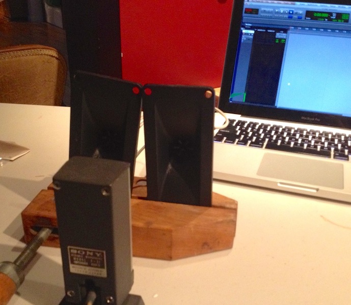

Used the time to do a lot of reading on the boards, run through the tweeters for loudness using capacitance function on my multimeter. (http://www.billfitzmaurice.info/forum/v ... 18&t=17047), and check polarity (my vid here: https://www.youtube.com/watch?v=NcgieJ5IWFQ) I used the wood clamp to hold the tweets, driver on right was middle loudness of the 30, ~136 uF. Used Audacity to push white noise and ProTools meters to read.
Out of 30 goldwoods, 2 were hot and 5 were low. At 50 I have some hearing loss, especially higher, and would not trust my ears, yet when checking polarity, could really hear/see the low ones. One of the first things I did was switch the polarity to see/hear the effect. The sound changed, not sure if it was quieter or not, but on ProTools it showed fully canceled! But when I made the video afterwards, the cancellation wouldn't repeat, the volume just did not go up and remained like only the one tweet was connected. So my initial finding is unverified! sigh.

The differences are readily apparent on 1016's. I've tested so many now I do it all by ear. There are 3 versions, low, avg, and high. The ones with lows emphasized are best for arrays, but they're fairly rare. Too infrequent for complete arrays. I do a mix of the avg and lows. The high ones fall into two categories, most are perfectly fine, just a shade higher, and a little more spl than any others, and some just suck, all top end. Those go in the scrap. Although sometimes if you pull them apart you'll find a blob of solder or something else causing it.
