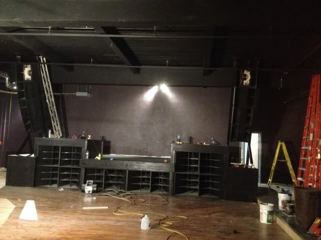

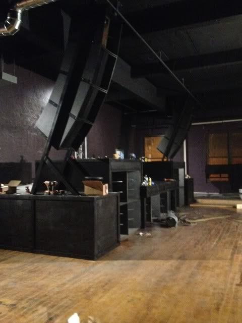

those bottom dr280s look like toooo much splay to me. they'll be covering barely any audience and causing major floor reflections.

There is only 50' of dance floor in front of them.. they aim perfectly at the 4 quarters of the dance floor.. These will be power shaded so those bottom 2 cabs will be running a lot less hot than the ones above them.. Besides this venue will be heavily packed so not much if any dance floor will be exposed ..sine143 wrote:those bottom dr280s look like toooo much splay to me. they'll be covering barely any audience and causing major floor reflections.

Do you plan on putting grills in front of everything?
Those subs look like they're just waiting for douchbags to toss their trash down the throats.
