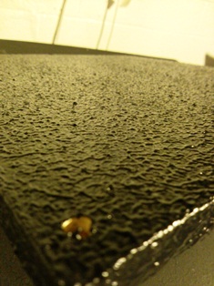

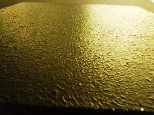

Quick shot of Duratex finish...almost done! Still gotta throw some v plates together, then Im done!

You may want to consider making your v-plates a full 1" thick. If you have a flush trim bit for your router, it's really easy to laminate two pieces together and trim the larger one to size. Check my T48 build thread towards the end for pics of my vplate build process. Very happy with mine.

Sweet looking subs, Clint.
I can't wait to read your review of .... 8 T48s !!!!
