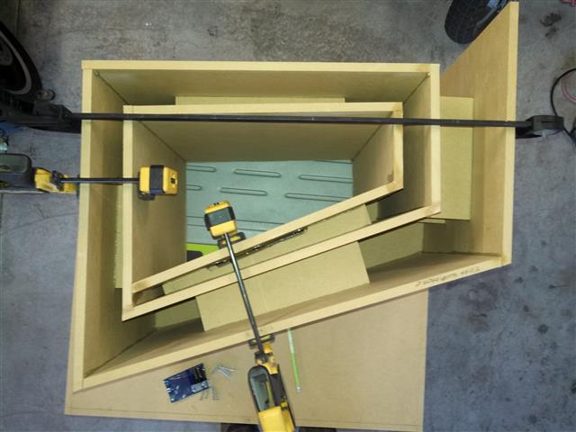

Hey everyone,
I started my table tuba build this morning. I'm building it out of 1/2" MDF which will be covered with a 1/4" oak veneer. Tomorrow I'll be ordering the Infinity Reference 860w from Amazon and the Dayton 100 watt plate amp from parts express. Last night I cut the two 29 3/4 x 29 3/4 pieces and ripped all the panel wood... I'm going with 17 inch panels. I traced everything out and installed panel one this morning. I learned a couple things so far:
#1 - Tracing the pattern in a mirror image in order to flip the mouth it is a pain in the a$$! (It would be cool if a mirror image was included in the plans.)
#2 - It pays to measure every panel traced out and compare them to the plans. I was off on the inner point where panel 8 and 9 come together. It was pretty easy to fix with an eraser. However, if I hadn't measured those all out first I would have got to panel 9 during assembly and been off by an inch.
#3 - I think next time I'll cut the inner hole just to the inside of the line then use a flush cut router bit to finish it after all the inner panels are in place.
#4 - It doesn't take much glue and the stuff oozes for like 5 minutes after you release the pressure on the caulk gun. I'm thinking on the next panel I'll only squeeze the caulk gun trigger for about half way through then just use the ooze for the other half.
Here are some pictures of my progress so far.

Thanks for the hint. I'll have to try that before I open the second tube. Here's pics of panel 1 and 2 together. The sub won't be here until tomorrow I haven't been ableo to work on panel 3 yet.
Another question... would it be wise to glue the braces on to each panel before installing the panel? I'm thinking this way I could just use clamps and avoid using nails or screws. So basically... for example, as panel 6 is clamped to the structure panel 7 could be measured, cut, and have braces 2/7 glued and clamped to it sitting on the sidelines waiting to be installed.
Also, I'm using an 8 inch driver with 17 inch panels. The plans call for two braces for panels over 16.5 inches. Brace 3/5 calls for a notch to be cut if the driver does not have a spacer. This is done so the speaker has room to move without hitting the brace. Could I install two braces (one on each side of the woofer) and skip the notches or will that change the sound? In my mind I picture the sound getting blocked by the braces on each side of the speaker. The braces are about 3.5 inches shorter than the panel.

You can put those 3-5 braces right on the edge of the baffle opening.

Tom Smit wrote:You can put those 3-5 braces right on the edge of the baffle opening.
Tom,
I got in there to do the 3/5 braces and with the T-nuts in place it was pushing them further out than I felt comfortable with. It probably would have been okay but it only took a few seconds on the scroll saw to cut the channels out and install them over the driver hole.
The braces aren't nearly as bad as I thought they'd be. I'm cheating a bit with a bench sander to get them to just the right size. I dry fit them with screws (hand tighten) through the loose panel being added. Then add glue and attach them to that panel. Finally add glue to the other side of the brace and attach the entire panel with screws and clamps. I'm going to remove the screws and fill the holes with PL before installing the next set of panels.
