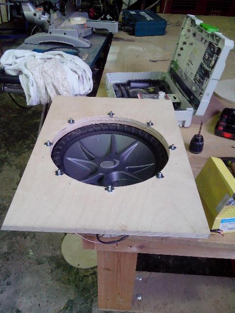

testfitting the cvx driver and checking for rubbing surround. no problems there. T-nuts were installed with the famous harley screw

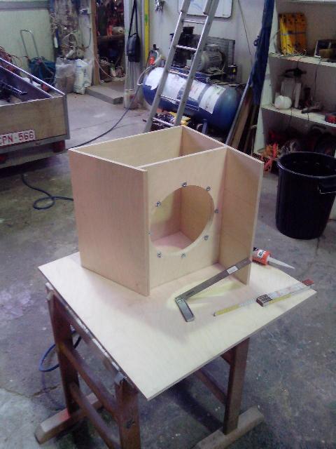

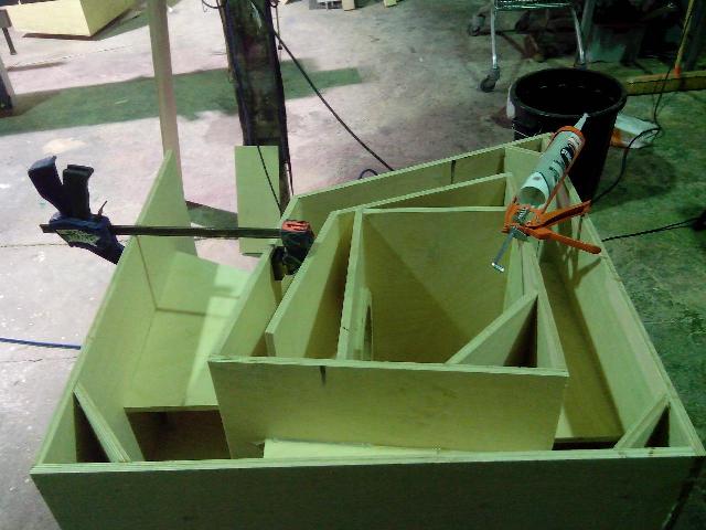

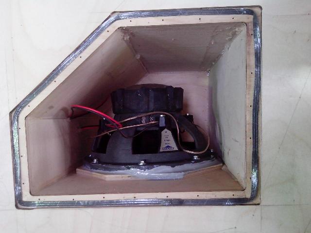

it was installed with gasket tape + some caulk around the edge to make sure there are no leaks. the cvx isn't intended to be front mounted

it seemed useless to to me to make the acces panel bigger than neccesary. i don't use the flanges either but route out half of the thickness of the side panel and half of the tickness of the acces panel edge . i have more room to install the driver this way.
