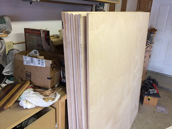

The good thing that resulted from this frustration was I picked up more BB for my two Tuba 45 builds coming next. 7 sheets of 1/2" in total. I also got a discount for more that 5 sheets... ended up costing $22.50 a sheet. Not bad.

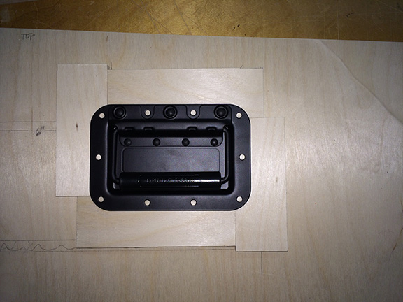

I'm attaching carry handles for the DR200's. I was going to just cut a mounting hole and then use speaker gasket tape to seal it off. But the inset for the handle is shallower than the thickness of the BB, so I decided to route a recess instead, to maintain the seal. Referenced the front top corner and squared to the front edge. The long rectangle in the middle with the squiggly lines are the reference to the middle brace where I will drill for the screws to attach, when I assemble the sides. The recess is on the outside of the sides.
I used scrap wood as guide jigs and attached them with carpet tape to the reference lines for the recess.
Checking the fit with the handles to make sure my measurements were accurate.
Used a plunge recess bit and set the depth, accounting for the jig. With the bit being so short, I had to route to the final depth in a couple of passes. I had this set up for all panels so I could route them simultaneously.
The wide clear base that I made for the router makes it easier to see what your doing.

Check fitting the handle.
After routing, the material left is pretty thin. I put it up against the sunlight and you can see the outline of the recess from the inside. I believe that it is about 2 layers thick.

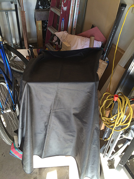

Before attaching the sides, I wanted to prepaint the insides of the horn. I masked off the areas I wanted. My flatbed provided a perfect height platform for painting. I first sprayed a primer coat followed by 3 coats of satin black.
The inside of the horns of the cab painted.
The inside of the side panels painted.
After they were dry to the touch, I want the paint to set for another couple of days to cure more. So while they're doing that I covered them to keep them clean from the sawdust. Sawdust you say?? Yep, gonna start work on the T45's... two of them. Starting a new thread for that build.
