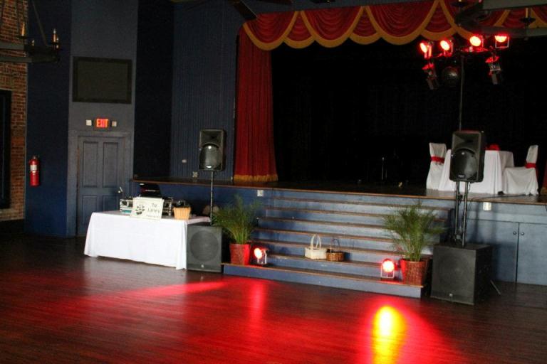

My typical setup for weddings 200 and under.  Shown are the 1801's I am looking to replace.

Welcome. There's more than amazing speaker plans here, also a lot of sound knowledge. You can spend long hours reading stuff that will actually help you do a better job.
Here's a way to get instant improvement: Buy speaker stands for the tops so you can get the subs out. Now stack your subs so that the cones are within two feet of the wall. We did this with my friend's non-BFM PA and the results were obvious.

Thanks Guys and I do have stands. The venue for this pic is notorious about setting up stuff in your way; to the immediate right of my speakers (opposite of my table) is where they put the cake, in both corners they ended up setting up cocktail tables.
Luckily I have started discussing this with people when they book this place.

It's all good, plenty of people set up just like that pic. :)
What a lot of people don't understand is, while it looks good aesthetically, it's actually causing frequency cancellations in the subs output band.
Splitting subs requires distance. 2 subs need to be more than 56 feet apart to not cause cancellation at 40Hz, and further still if you're getting lower than that out of those cabs.
If you can't point them at a wall or corner, at least have them together, side by side. Use one of your stands to hold up the other top on the other side. It looks different, but sounds better.
And try this one day (even at home), put your tops vertically stacked, with HF horn to HF horn (ie top cab upside down). This increases HF output...
