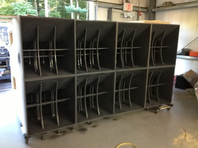

Absolutely awesome.

Sorry, I'm lost for words :hyper: :clap: :cowboy: :chainsaw: :loler: :noob: 8)

I don't usually get aroused by inanimate objects but man those are beautiful...

Especially liking the curves on the braces. Mmmmmm

Thanks a million guys! I'm really starting to get pumped up, more pics to come soon as I'll be starting the install into the club :hyper:

Oh yah its about to go down! I should have my Driverack tomorrow so I'm going to fire all of them up and hurt myself :loler:

Just looking at that photo is enough to cause an eargasm.... :shock:

Just put a mattress against the back wall and lean against it when you fire them bad boys up. That way you shouldn't go flying too much.

Please, be very sure to do a polarity test before you close them all up! VERY IMPORTANT!!!
This insures that all the cones move forward at the same time when there is positive power to the positive terminal. Wire a 9 volt battery to a speakon wired + to +, - to -. Plug into the jack plate and the cone should move forward and stay there.

Thanks DJPhatman.. I'll double and triple check the polarity..

Are you not going to paint the sides Bob?
