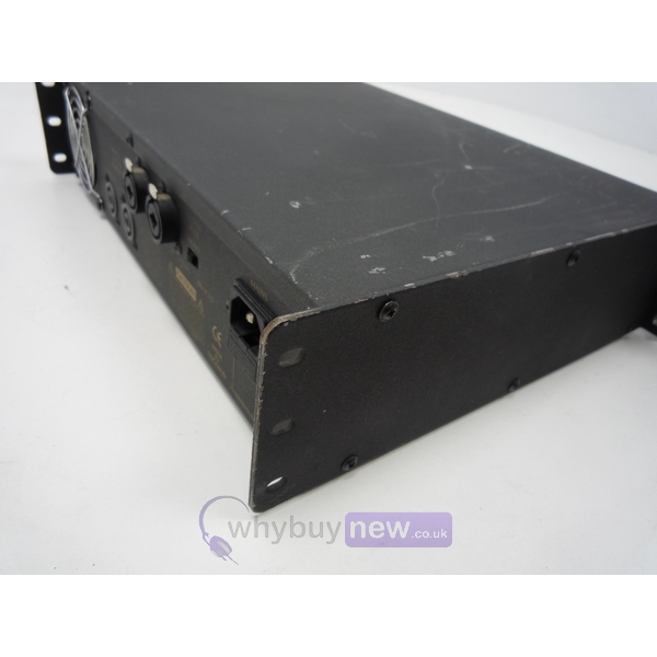

http://www.ebay.co.uk/itm/Citronic-PPX1 ... 1164000827
and a buy it now:
http://www.ebay.co.uk/itm/C-AUDIO-SR606 ... 1156706938
I'm not too bothered about weight - not moving these things every day. Besides, the cabs will weigh more than any amp, and I have a trolley for the former.
Any thoughts, anyone?
