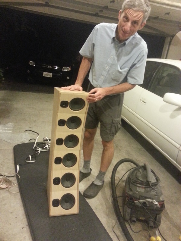

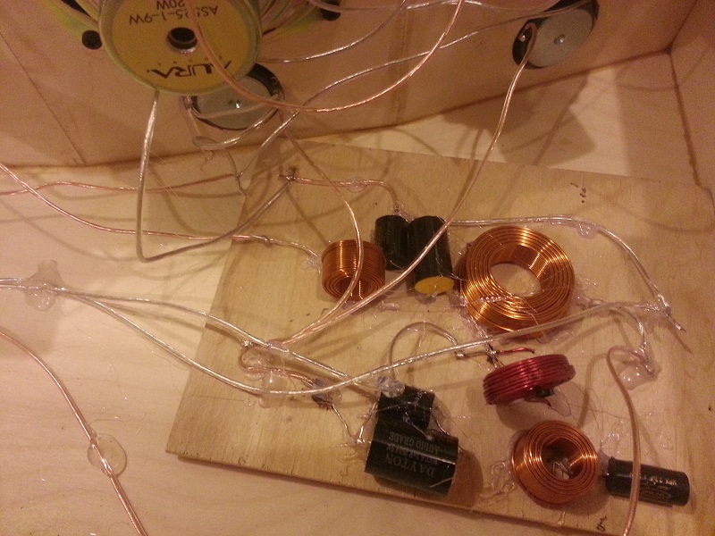

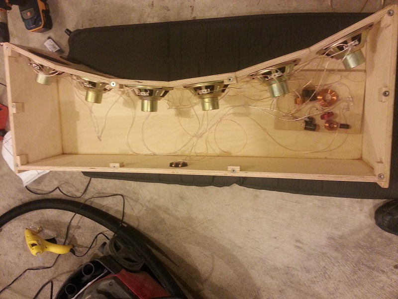

Finished the cab tonight, looking mighty pretty (considering I built it). I had to file down the tweeter holes to make them fit. I did the before mentioned triple drilling in order to avoid cracking tweeter frames but one still ended breaking (that's why I buy extra  ). Regardless enjoy the photos, I apologize in advance, there are a lot of them.
All Wired Up (front) All Wired Up (internal) Can you tell I like hot glue?
). Regardless enjoy the photos, I apologize in advance, there are a lot of them.All Wired Up (front) All Wired Up (internal) Can you tell I like hot glue?

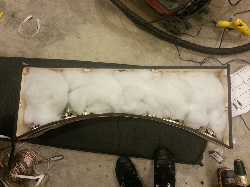

Finish photographs part 2
You can never have too much pillow stuffing Gasket tape all around with machine screws + inserts, you bet it's airtight Dad likes it I love the tiger stripes (end grain of BB visible from front)

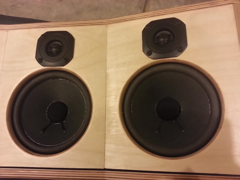

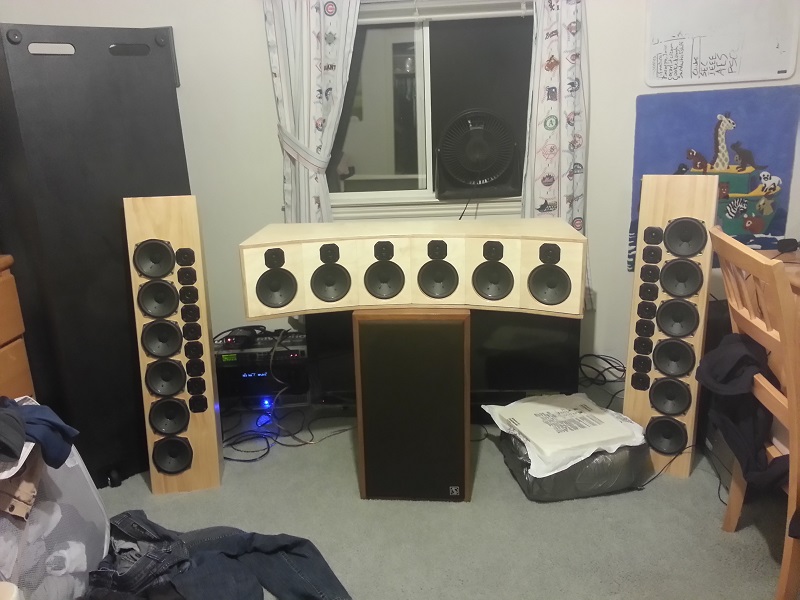

Last part
Woofer close-up Yep, it's as big as my TLAH's That's 18 5.25 inch drivers and 24 tweeters for those who are counting
