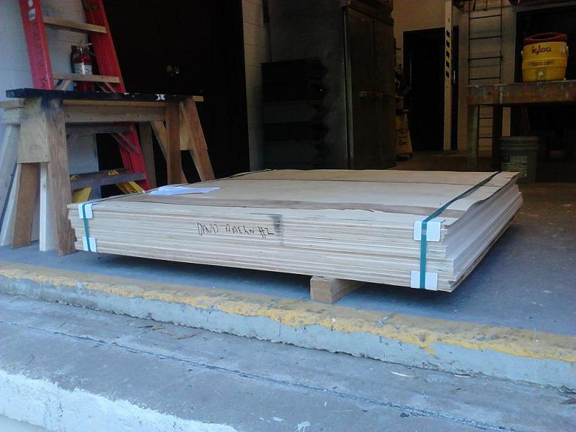

I just recieved my own 'build it yourself flatpack kit'..... Now to make with the sawdust!
Don't worry, I'll start another thread once I get rolling!
