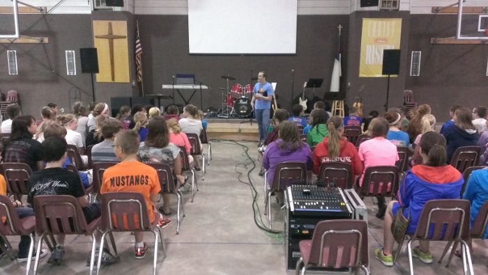

Thursday night I got to give the system it's real maiden voyage with the youth band. It was in a smallish room - maybe 1500 sqft or so. Sounded OK in there (just OK). Didn't get a chance to do any tweaking or anything. The subs were definitely kicking, so I was mostly just happy that everything was working.

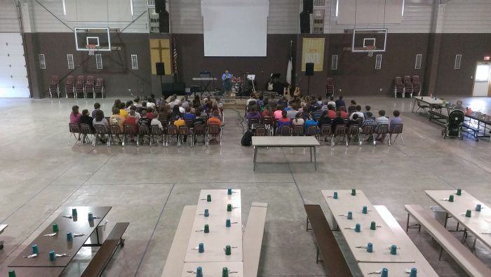

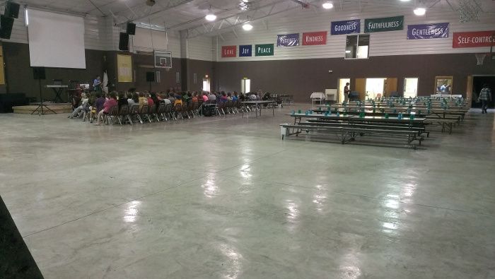

Today we hauled it all to camp and set up in their large multi-purpose room.
It's a pretty good sized room - gymnasium sized. Now obviously my 1x12" PA speakers and just a pair of T39's isn't going to fill the entire room with bone crushing sound, but I was pleasantly surprised how good it sounded. Really, it just needed to adequately cover the 100 or so kids sitting in front of it, but I was surprised that the sound carried pretty nicely throughout the whole room. I mostly just have the kick and bass going through the subs, but man does that make a huge difference. Of course, they'll be playing music from an iPod or CD player quite a bit, and that sounds down-right amazing. I have to say that initially I was a bit skeptical about 12" subs - even if they were horn loaded. I'm honestly surprised how well they work. I ran the auto-RTA on my processor, and that did a nice job flattening things out - the system sounds really smooth and punchy. Much better than it has any right to sound for how little I have invested in it

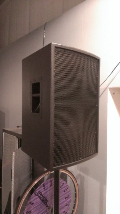

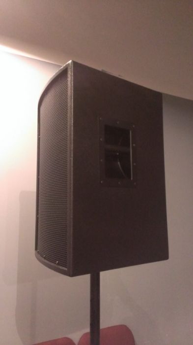

Looks like a quality build. Do you have any close up pictures of the subs & tops?
Re: Titan 39 Build
Unfortunately all of my close-up pictures have been in crappy lighting with my cell phone, so they look pretty terrible. Really not much to see. Maybe later this week I'll try to take some pics of them with my DSLR.

Looking great!
Not a criticism, but you would have got 3dB extra by V plating your T39's (rather than having them upright side by side), and more again if you had wall loaded them at the rear wall.
The stage area doesn't look terrribly deep and some say tops leading LF isn't to bad, there would only be a 10-15msec difference...
Re: Titan 39 Build
I have a piece of plywood in the garage reserved for a v-plate, but didn't have time to make it yet. We were in a bit of a rush to get set up, and were more concerned with getting them in a location where they wouldn't be messed with than absolute best sound or output. I wasn't too worried about output, honestly - the subs out-run the tops by maybe 6db, so I didn't really feel like I needed to put too much effort into positioning to gain more volume. I only had time to sound check them with one song, so I didn't get time to tweak things much. Honestly, I ran the auto EQ and was quite happy with how it sounded. It pulled out some of the low mids which did help get rid of some mud from the room. The nice thing about having strong subs is you can push the bass and kick and that can cover a multitude of other sins
