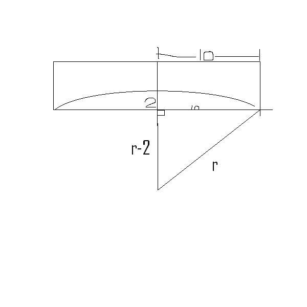

Re: Titan 39 Build
Here's how I figured out how to calculate the radius of whatever arc you want on your braces. Just put in whatever numbers you want and solve for r.
