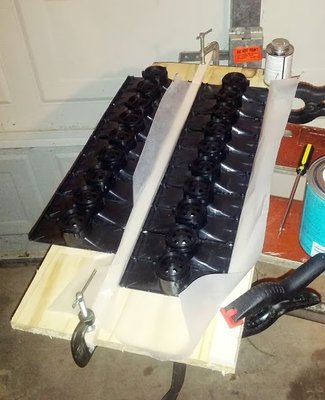

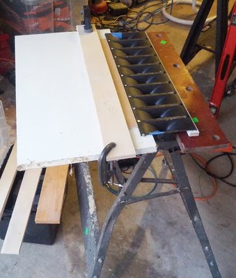

Tweeters were glued together between two scraps of wood to keep them straight, then one end was screwed to the array upright. The other end was screwed to a board, and a section of 1/4 ply was laid alongside it to support the shoe of the circular saw. A guide board was added to run the circular saw along, and then it was a surprisingly easy cut using the standard general-purpose blade.

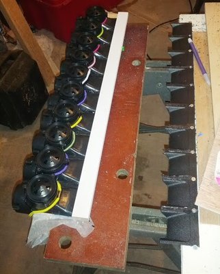

Multicolored hair ties were then used to hold them together over a corner jig.
I'd still feel WAY more comfortable doing this on a table saw, but it can be done!
