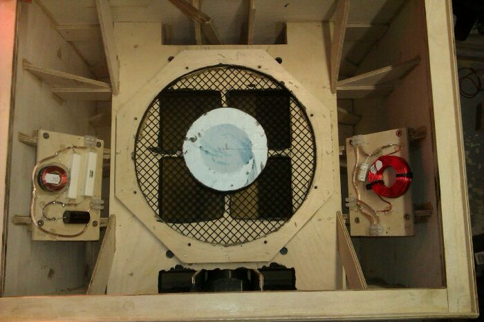

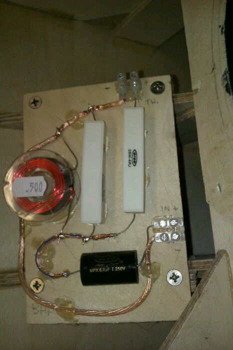

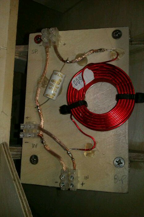

Made the first set of crossovers tonight. I've used speaker wire as a kind of bus system and soldered to it where required. I've stuck stuff down with hot glue. The idea is that the IN from the jacks on the back panel will go to the LP board on the right side, and link out to the HP board on the left, with the link wire hot glued along the baffle under the speaker

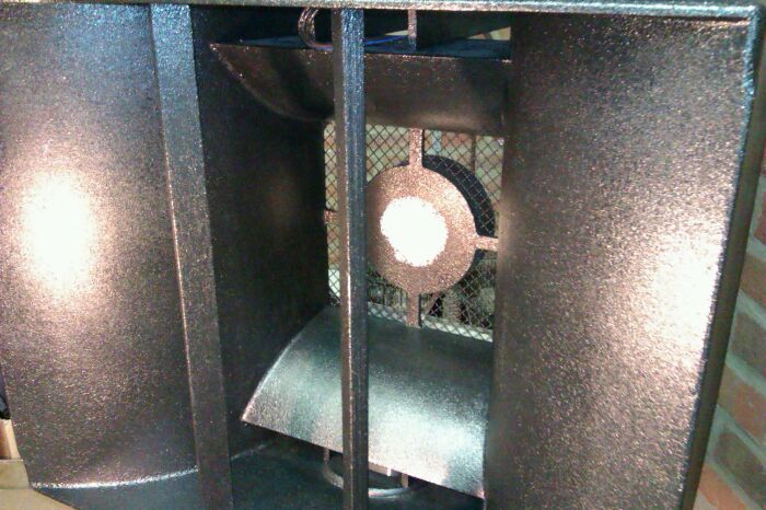

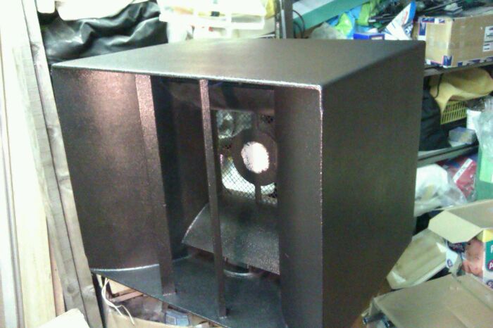

This is the duratexing over with. 2 foam rolled layers and 1 textured roller. You can still see a bit of wood grain through the texture in places, though i did sand the cab first. I don't know what most people feel about duratex application but i was going over my marriage vows, particularly the 'for better or for worse' one. I don't have the patience for perfectionism, and that includes taking effective pictures of duratexing.
