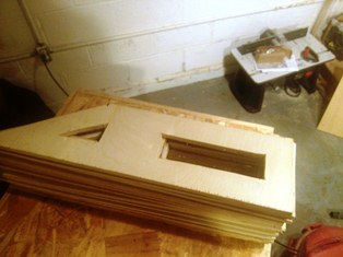

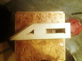

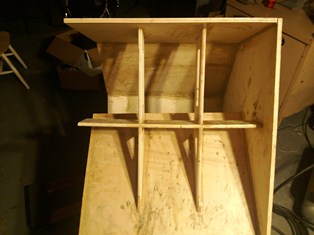

Oh man the jig saw was screaming tonight :chainsaw: :chainsaw: Not gonna lie, that took awhile!
So should I hit the fronts and inside cutout parts with a round-over bit? My concern is that the bit wont get into the little square and triangular grooves inside the braces leaving considerable portions of the inside cutouts without the round-over effect. Also, I worry that if I do the front of the braces or the long end not up against the panel, that i could damage the tip on top, causing problems with mounting them to the panel.
Let me know what you guys think. I just think the round-over would really make the braces look better and the boxes more professional.

Is that a small router table I see on the floor? If so, you should be able to put a gentle roundover (1/4"?) on there with no problem. Not sure how well you can roundover INSIDE the cutouts, but the outer edges should be cake. Looking GREAT! Keep it up!
Posts: 7671
Re: Titan 48x8 build
#110 Post by Tom Smit »
After using a router round-over bit, you could use a file (round or semi-round) to touch up the last little bit, if you want.

Just run the router bit inside of the cutout and flip the piece to do the other side. Job done!

Braces turned out great and you saved a couple of pounds in the process! Thanks for the update...now get back to the garage. ;)

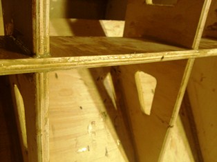

I am in the process of sanding and mounting the final side on all these boxes. Got four sides mounted and three boxes sanded at this point. Ill post some pics soon of the boxes after they have been sanded. They look pretty good. Only issue I have ran into at this point is the bottom bracing. I am thinking that those should go on last for sure. On a couple I am having problems lining the bottom panel up. I am getting them but I have had to knock the braces of the bottom panel in order to pull the bottom panel out enough to line it up with the final outside panel. Plus it would be a lot easier to access inside the box had the braces not been installed. It looks like all the panels sealed well with PL so I am not too worried about leaks. If this is the worst issue I have building these (all 8) for the first time I won’t complain! :hyper:

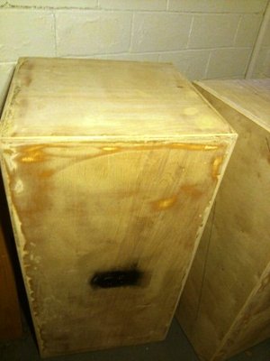

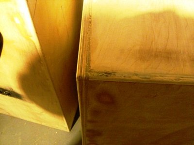

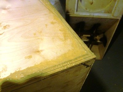

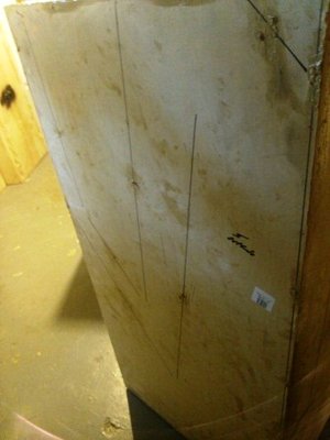

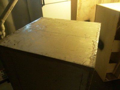

Here are some random before and after sanding pics, sorry they are kinda rondom and low quality.....almost ready to paint/duracoat! :hyper: I get a little outta control with the PL..mostly becasue I dont want to take the chance of having a leak....and partial becasue my woodworking skills are now medocare; :chainsaw: before this project they were just plain bad..but hey, im getting better! :noob:
This looks rough but its actually very smooth.
outta control PL..somtimes i drink while gluing

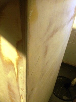

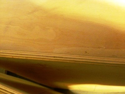

few more pics. I think they will finish up nice. I had to use a little filler in spots for screw holes and corners..they just look a little rough in the pics but they are really quite smooth and they appear to be very well sealed. Hopefully no leaks!

Looking good! I agree with going overboard with the PL. Better to not need it than to have a leak. Keep up the good work!
