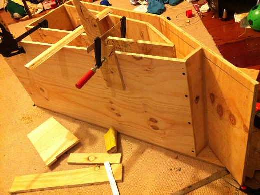

final panel installed, phew! now for those braces... ugh, string and pins to measure the oval cutout shapes, no fancy tools here! Pretty happy with them so far. Just have the two reflector panels at the rear and a few braces to go. Final side is ready to go, driver run in, oh yeah, also have to do access panel flanges... doh.
P.S. those braces are just sitting there, not glued in yet, the horizontal cuts would be difficult if they were!

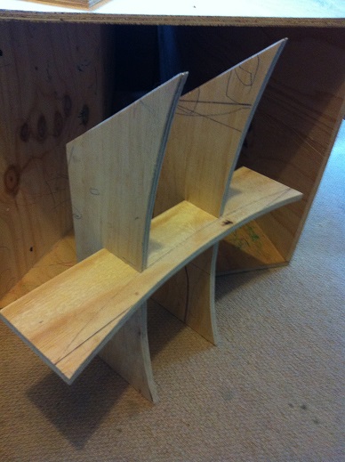

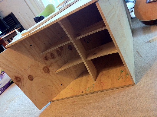

#42 Post by fester »
almost there! I wanted to ask opinions on the design of the final brace... In the sketchup model the curved braces are flush where they meet, but I cut my horizontal brace a bit too shallow. It doesn't look all that bad, I'm just wondering if it really needs to be flush? I had a really hard time getting the curves right with my string and pin method!
I'm guessing that it wont make a lot of difference to the sound, as you can just do 90 degree cuts on these braces, but just checking.
here are some pics showing what my current front brace looks like:

fester wrote:almost there! I wanted to ask opinions on the design of the final brace... In the sketchup model the curved braces are flush where they meet, but I cut my horizontal brace a bit too shallow. It doesn't look all that bad, I'm just wondering if it really needs to be flush? I had a really hard time getting the curves right with my string and pin method!

Re: T45 the baby T60 is born :)
#44 Post by Titanium Hand »
I imagine that as long as the minimum size of the horizontal brace (as prescribed in plans) is in the correct location on both of the sides it shouldn't be an issue.
You probably have a 'deeper' brace than was specified anyway, to accommodate the glorious curves? ? ?
Cab is looking near on identical with the T60 I just built. Interesting that you are questioning some of your measurements, I always confuse myself whilst setting out the panel lines; struggle to decide precisely where to put them - 1/2 inch this side of the line / or 1/2 inch that side of the line :noob: Never had any dramas regarding what to do with lines before that :wink:

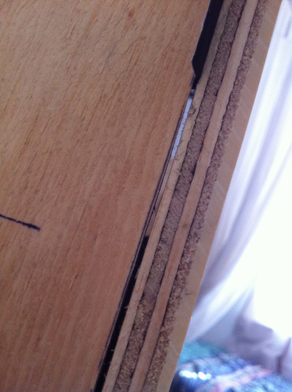

#45 Post by fester »
as I posted in another thread, I have just tried an experiment with the final panel on this sub... I put gasket tape (like driver cover) along all of the edges of all panels that are flush with the final side (except for a small bit at the end... ran out of tape!). I then screwed the final side in place and proceeded to run a leak/rattle test with the cover off.
Mind blown.
no leaks, amazing bass at 20v (high/low pass set on the driverack), actually I lie, there is a leak, where i ran out of tape! I have attached a pic of the small 2 inch section where I didn't have enough tape, there was a LOT of air shooting out here, I was very surprised how much actually, especially at the mouth of the horn, I expected it to be less.
