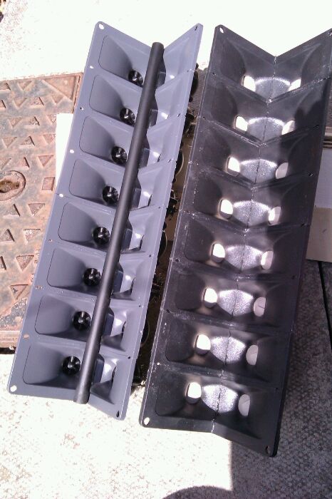

Charles Jenkinson wrote: And now, because i have alternated the handing of the piezos (so I didn't have to cut through the screws), and i cannot rotate the elements (because they're glued in), it will be easier to see parts of the wiring in the back of the array. The wire Leland supplied is a sort of grey/clear 2 core - I'm wondering if a black sheath single core might blend in better, or whether to put some grill cloth round the back of the array and screw it into the back of the array support rails, just to screen off the back of the array, when viewed obliquely.
Can you find some of this stuff and slide it over top of the harness? http://www.google.ca/imgres?imgurl=http ... Q&dur=1843

Hey Charles,
Have you built the supports for the array yet?
If so, just place the array in position and have a look from a few angles. It may not be as bad as you think.
If you've wired it up already, you don't want to un solder your wiring to add a sheath.
Maybe a few squirts from a flat black rattle tin????

Thank you for the considerations Tom and Grant. I haven't soldered them up yet, nor are the mount rails in situ. The only issue is the tabs on the element backs. It's not a big deal, it ideally just needs something to neaten it up. I think I'll just get some black wire and that will do.

I think you are the only one who will notice. I brought the J10L out to the beach this weekend and no one even knew that it was a loudspeaker. If some wires are visible from a steep side angle probably not many will notice, and those that do won't think any different.

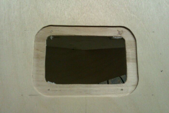

Since last posting I have done some rounding over on the corners with the router, and trimmed the face edges back on the plastic corners, so they look a bit better and are more functional for fitting the cabinet back, particularly where 6mm thick ply is used. I thought I would try and recess the jack plate last night, taking 2mm out so it sits in and hides the gasket. Easier said than done. I free handed some bits, the corners mainly. It may look tidier when painted. This is the good one.
