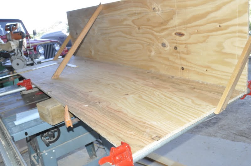

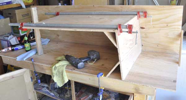

Starting my first BF speaker. THTLP. 18" by 24". I got my photos out of order. This post should be second.

Starting my first BF speaker. THTLP. 18" by 24". This post should be first.

OK, so sometimes what I read is not the same as what is printed on the page... Bill's plans refer to allen head screws and lock washers. I read machine screws and nuts. Wood screws and lock washers sound much simpler.
I installed a couple more panels on Sunday.
