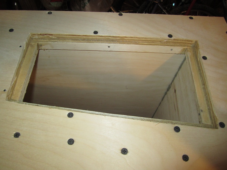

Since I don't have access to a router, I made mounting flanges for the access panels at 3/4" wide on one side, and only 1/4" wide on the other side, so as to make the driver just barely fit inside. The 1/4" is thin but works. I just had to angle the screws in at a 45 in some places so as to have adequate grip on the wood.

Here are some pictures that show how I attached the access panels, as well as a size comparison to T39 slim. Its actually very similar in size to T39 except for the extra 7 inches of height.
I used heavy threaded wood screws for attaching the access panels for simplicity, and since I didn't have enough space on the 1/4" access flange for hurricane nuts, etc.
Re: Autotuba 19/10 gto1004d
Hey Ryan,
Wow, I didn't realise the AT was quite as big as it is. Your comparison to the T39 gives me a real sense of their size.
No wonder they go off in a car...
