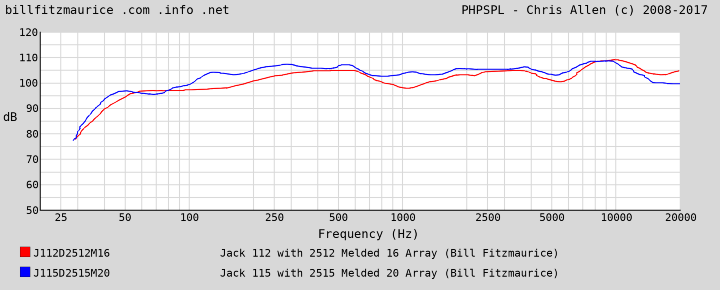

I'm really curious how much "better" the J15 is over a J12... here comes my favorite, Chris' SPL Chart widget!:
I'm not sure, because I've never heard a J12, but I'd bet the octave and a half between 100Hz and 300Hz is pretty significant. The low end extension is a bonus too.

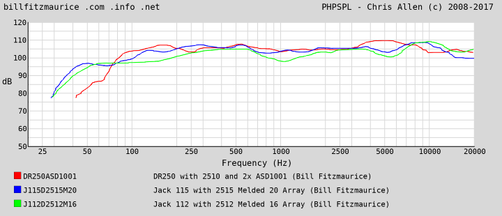

I prefer the sound of the DR250 over the J15. I suspect the reason is the increased sensitivity in the 90Hz-200Hz range. I have no data to confirm this, though. In any case, if you fiddle with the vertical axis on the chart, the difference between the J12 and J15 becomes more apparent:
