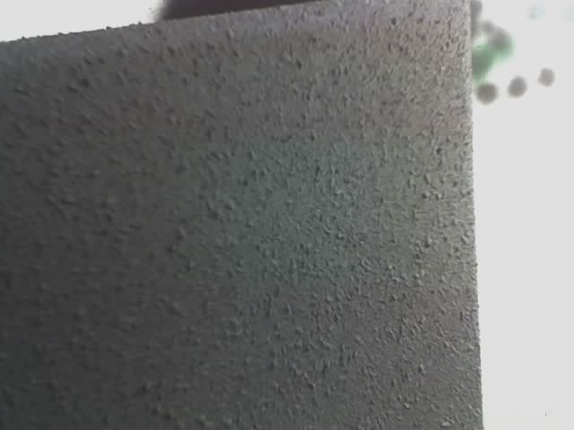

i have recently completed a build on a titan 39 and, it was my first experience with duratex. the results i got were acceptable, but not perfect. (i first coated with a roller, and second coated with a spray hopper) the texture that i wanted wasn't there. this was due in part to my lack of experience with the product. another thing, it wasn't quite as hard as i'd hoped for. don't get me wrong it is very tough, but it's still soft enough to dent with a fingernail using moderate pressure. with the remaining amount that i had left over i decided i need to practice to get a feel for working with the stuff, so i immediately ripped all the old carpet off an old swr basic black that i got ahold of for cheap. then i decided to think outside the box. i mixed the duratex about half and half with tightbond glue and sprayed a small piece of plywood. texture was great. the next day it was hard as a rock. flattens the sheel a little and gives it a dark grey color as opposed to black. my basic black cabinet is now drying with the final coat and the texture is really darn good (considering it's my second atempt, actually it's good enough i would put my name on it. i'll post some pics later)
i don't know if this is something that is even remotely reccommended, but according to my test piece the new improved finish seems remarkably durable. will update later.

on my titan the duratex has been setting for a couple of weeks so it is fully cured. it's tough stuff, but the new formula is just harder, and tightbond (blue label) is about $15 a gallon. i do believe that i could now get most any texture i wanted with just straight duratex. that just comes with getting a feel for working with a new product, but for me the results with my experiment have been quite positive, for my personal needs.

well on a positive note, the new coating seems to be stable. it really is rock hard, and i'm lovin' the way it looks. seriously it's hard enough to skin your knuckles on with the extra rough texture.
