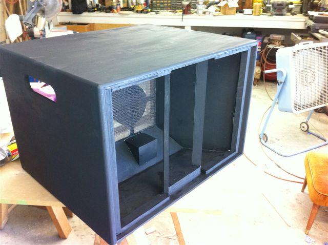

Array braces in place. These were a bit more of a PITA than I thought they would be, especially the angled braces. I thought for a split second about just going with straight arrays for all the cabs, to avoid all this jig mess...but just for a second.
I guess I also need to attach the grill braces, right? Better to do it now, before I spray paint everything in black primer. Need to read the plans on that...not sure how far back the grill braces should be from the front edge. Also, I'm not planning on putting any grill braces on the horn panels; just on the top and bottom of the cab. Seen a few OTops done like this...doesn't seem to hurt anything.

Re: OTop12 Build Thread
I'm a little confused on what to do about grill braces. I'm not sure whether to:
A. Cut 1" square pieces of 1/2" ply and put 4 across the top/4 across the bottom
B. Cut longer strips of 1/2" ply to give the grill more contact points
Would full-width grill mounting strips block too much sound coming out of the horn mouth?

- Posts: 8680
Here's how I did mine. Plywood strips. The ones on the sides are beveled to keep 'em straight.
Great pic. Thanks, Bruce. So you did make beveled strips for the horn panels, huh? I wonder if I can get away without those? I have some time to mull it over as I'm not planning on bondo-ing and priming the cab for a few days.
