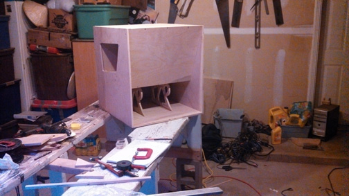

What i learned today is that the outermost panels that are most parallel to the outside determine the final Square of the cab, but i'll have to think about that to see if i can prevent that in the TUBA 24 #2 build. overall i'm happy with this build since all of the cuts have lined up with minimal fuss.

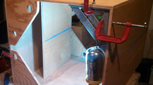

Panel 6 & 5 Brace
Panel 6 & 5 Brace
Panel 6
Panel 6

Panel 7 was cut from a newer cut of 21' width ply that was about an 1/8 shorter than the first 6 panels. the cab was square until i installed this panel. For the next tuba panels 1 and 7 are going to be cut consecutively and i'll see what happens.

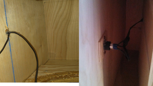

using all the four pole speakons connectors so that we can run them parallel if we need to.

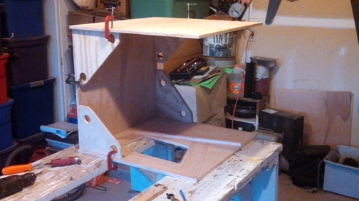

The liberties in design seems to be the shape of the braces.
All inside panels are glued now to remove the sides and reglue them.
Panel 11 installed as I cap one side. An interesting thing happened when i took off the side panels. the twist almost disappeared.
