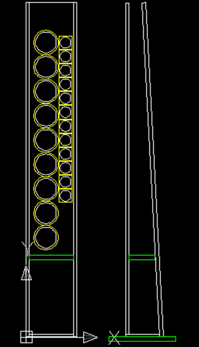

Question about the cabinet dimensions.
In the plans it says that you can lengthen the cab to allow for the 9th driver in the rectangular version. My question is how much can you lengthen the cabinet? My vision would be to have these as floorstanding speakers that would sit next to my HT system. If I could lengthen the cab to 5ft I would not need floor stands and it would give the baffle a nice long look to it. I did a mock up in autocad to show my idea. I also included a spacer at the bottom of the woofer line that would keep the inside dimensions of the cab the same as the regular version. But with that spacer im not sure how it would affect the acoustics of the cabinet because there would be an extra space on the bottom of the cab.
- Posts: 29153
Re: TLAHx2 for HT Mains
5 feet is fine.
Is the spacer in the cabinet needed or can it all be left open?
- Posts: 29153
You can leave it open.
