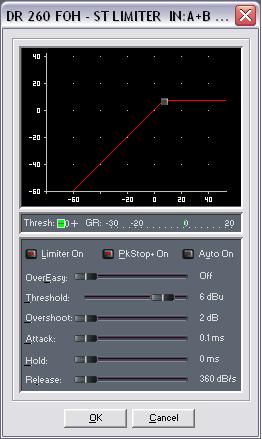

Alright here's a screenshot of the limiter for the subs (even though this happens on all the limiters)
Peak stop is on, but isn't doing anything to help stop the sudden inrush that's clipping the amps. (The amp's clip lights come and the signal is clipped). So if I had a drummer slamming the kick to the beat, the amp would be clipped everytime he hits it. But if bass is sent through it brings the peak down and maintains that gain until the signal stops for a moment and then comes back.
I've tried messing with all the settings. Best I can come up with is the processor isn't catching the signal fast enough.

Based on the pic of the settings, it looks like OverEasy is engaged. If I remember right, that will allow it to go past the limit and bring it down easy....as in the name.
I think you want that set to off.
Edit.....now that I look at it again - it may be set to off. I don't know if you have to move the fader all the way over for it to be off or not. Anyway, check that out.

It's been a while since I set one of these up, so I went back and read through the manual. To start with, the 260 is not a brickwall limiter per se. However, with Peakstop, the manual does indicate that you should be able to achieve the desired functionality.
It looks like you have to turn Peakstop on, then lower your threshold by the number of db that you have set as your overshoot. In other words, if you want to limit to 60v and a +6dbu threshold does do that except for peaks, you should lower that to +4, with Overshoot of 2. That will keep you 2db below your limit normally, and "clamp" the peaks that the 0.01ms attack causes at the real voltage limit. All this makes sense for what you're measuring. If +6 is a 60 volt RMS limit, you'd have to double the power to 84v to achieve a 3db difference... given that you're getting 70-80v peaks, that's in line with 2db overshoot.
If it works, this should end up sounding better than a standard brickwall limiter which just squares off the wave and distorts. If it doesn't work exactly as it claims, then it probably isn't a suitable limiter for horn subs.
