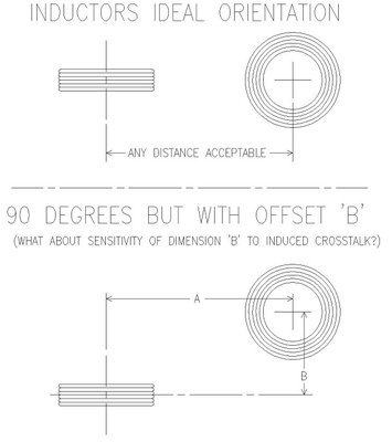

I have sourced all the crossover components from speaker hardware, but not the copper-surface laminated mounting board. I was thinking of getting the proper board but in reading about crosstalk I noticed that the particular subject and effect of '90 degree inductor orientation BUT with an OFFSET from the plane of one to the axis of the other' is not easy to find in the literature. All the info I could find shows crosstalk results for the plane of the inductor at 90 degrees aiming directly at the axis of the one perpendicular to it. I drew up the following diagram to illustrate the offset situation. It illustrates the layout of the components as shown on the speakerhardware version of the crossover I need to make .(http://www.speakerhardware.com/prebuilt ... -piezo.php)
How sensitive is crosstalk to dimension B? ...I appreciate it's all relative to the dimension A.

Put the high pass and low pass filters on separate boards and you won't have to worry about it.

Hi Charles,
Bill is very consistent in his statement, he always says it.
One reason in particular is it is much easier to see component layout should a crossover problem occur.
I found assembling two smaller boards easier to contend with.
You can see in both of my DR and WH8 build threads separate board and placement pics.
It should work well for your build as well...

Re: Inductor Orientation for minimised crosstalk
+1 Its much easier to get the crossovers right if you put them on separate boards
