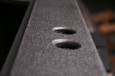

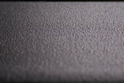

If you like them with 1 coat you will love them when you get 2 or more coats on them. I made the mistake on my T39's of going overboard on the bodywork of the cabs trying to get every little area ready for the finish.
During the first coat I found a spot that I had missed after going over it with the Duratex. As the spot was inside the mouth of the cab I decided to see what it was able to cover as opposed to trying to sand off the Duratex and doing more bodywork. I was quite impressed at the ability of the Duratex to cover what would have been a substantial flaw if I had been using any other finishing system.
After 2 coats you could not tell where the flaw had been. Still to this day I can not point out the exact point where the flaw was just the general area because I know where it was to begin with.
Bottom line with Duratex is don't beat yourself up getting the cabs ready for a traditional painted surface as the extra detail is not needed for this finishing product. It is very forgiving within reason.

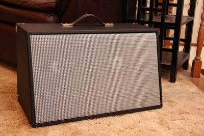

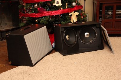

Ok, so I'll do a more comprehensive post later, but finished the cabs at 2am last night. Finishing touch was the grille. Dang, I've never wrapped this stuff before. Fortunately, I had my crafty wife helping and we got it. Still needs Velcro on the corners. Maybe tomorrow.
We did most of our Christmas stuff today, so both boys got their cabs this morning. The 21-year-old knew what had been going on in the garage, but the 16-year-old had no clue. You should have seen their faces when we pulled these out of the back room. Worth every minute x2!
Here are some pix to tide you over for the holidays. I'll get more pix and detail in a later post.
Merry Christmas everyone!

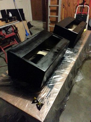

Thanks for the compliments everyone. They really did turn out nice and it was a lot of fun. As the boys were cranking things up Christmas Eve morning, I told my wife "this reminds me of when we bought real drums for Ryan (our 14-year-old drummer). That's right, we could be the next Partridge Family. 7 kids and 6 of them play at least one instrument. We have a drummer, bassist/guitarist, guitarist, keyboard/violin, keyboard/guitar and trumpet/violin. Most can sing. Plus, I do pro sound and my wife can do the promo photos. We should buy an old school bus and paint it...
Ok, so a few more build pix and then some thoughts.
I was over at Leland's shop the other day and saw these little yellow (and black) pyramids at his paint station. Made a mental note. Saw a fresh pack at Lowes and figured if they're good enough for him... Maybe everyone else knows about these, but I didn't. Really nice little fix for painting. Helps keep the edges clean and nothing sticks to anything. Cheap too. Sweet.
I did a quick spray paint primer coat for a few reasons. First, it really shows the boo-boos. Second it helps seal the wood and third, a black substrate for your Duratex is helpful. Kinda gets you a step ahead in the coverage department.

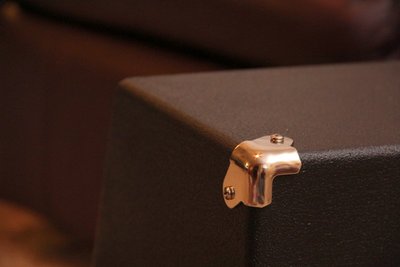

After staring at first, bare wood, and then finished wood, a little hardware goes a long way to complete the project. You can't see them in any of the pix, but there are beefy rubber feet on the bottom too.

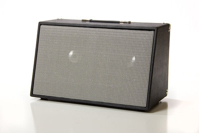

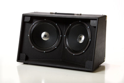

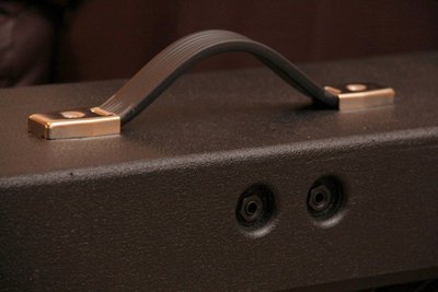

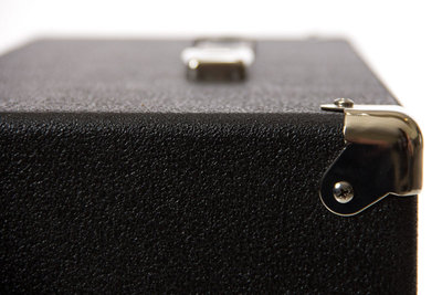

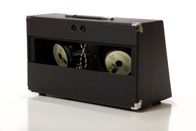

Final thoughts and beauty shots:
The boys put a cabinet through its paces last night with a variety of gear and I've got to say these are very nice sounding boxes. One of their guitar genius friends came over too - he's played through all kinds of rigs - and he was very impressed with the tone, flexibility and neutrality. Worked well for every style he played and gave him exactly what he wanted.
Although I still don't have the damping material inside, we sealed up the back for a bit to hear the difference. Sealed doesn't seem to effect the tone so much as the tightness. Notes were better defined sealed and a somewhat looser open-backed. Cabinet was in the middle of the living room, so we still don't know about wall loading, but I can guess. Stereo chorus and reverb is is really nice and makes things sound wider than they really are. So, if you're interested in stereo, it really works - at least up close.
We had the photo studio set up yesterday with our high-key white background, so I decided to do some proper pix of the cabinets and the boys rigs. While editing pix this morning, my wife commented that she really likes the look of Duratex. I love my wife!
