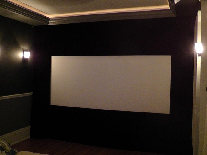

Here is the theater its going in.
It'll go behind the screen wall. Which is the reason for the low profile choice. Its going to be a squeeze to get in even the LP. I'm hoping i can make a 24X18X72 fit.

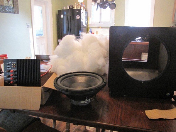

Here is the Rava sub disassembled. I'm really sorry Adire Audio went out of business. I searched long and hard for the best bang for buck sub i could at the time. If i remember right I got this sub delivered to my door step for like $375. Its been rocking out for a long time. In fact last night my son was watching finding nemo and it was shaking the whole house and doing it well. I cant WAIT for the THTLP...I think it will be the first time i'll have experience real bass. I'm hoping to get the low end tactile feel...I want to go from wow thats an impressive sub, to OMG WTF was that?! :lol:
Also, its not the MK II its actually the MKIII. I think all the T/S parameters are very similar though. Its foam surround with a kevlar/paper cone.
I just got to thinking...that driver is nearly 10 years old....is that any sort of an issue using it in this application? Whats the average lifespan of a driver like that? Its been used but not overly so...maybe abused...once or twice... :twisted:
