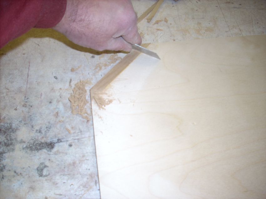

Here is a shot of a very handy tool no woodworker should be without.

It is a cabinet scraper, and if you look carefully, it was made out of a cheep saw blade I found at the dollar store. I cut the saw blade into three pieces (it was not a very big saw) and used a grinder to take off the teeth. Be careful not to get the blade too hot when grinding off the teeth.
Almost ready to be a useful tool - put the blade in a vice and use a file carefully to flatten the edge of the blade. Then use something hard - I use an old pocket screw drill bit; they are hard as heck, but a phillips screw driver shank works too, and push down hard at a little angle and push the bit/shank down the edge of the blade. This puts a hook on the scraper.
After a little practice, you will be sharpening the scraper good enough that it will take nice shavings on hard wood.
You can use this tool to scrape out that nasty PL adhesive, or scrape down the overhang wood edge on the board extenders.

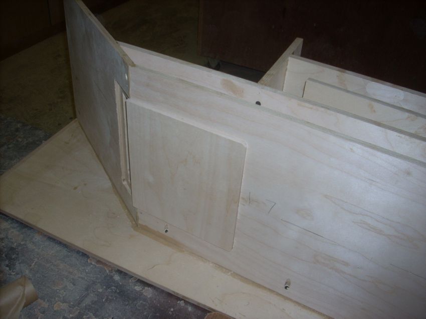

Started with the fun stuff. Had to make the insert pieces for the access panels. Started wit the fun ones first. Measured the height exactly, left the length a little long to the angled section.
Used the edge sander to round over the corners. We have a combo disc sander / vertical belt sander that would be better to do this, but it is not normally plugged in and plugging in the sander would take longer than doing the whole thing on the edge sander.
I really like that edge sander. Use it all the time. If you have a table saw already and are looking for the next big item for your wood shop, think edge sander.
Checked the fit on the cut out.

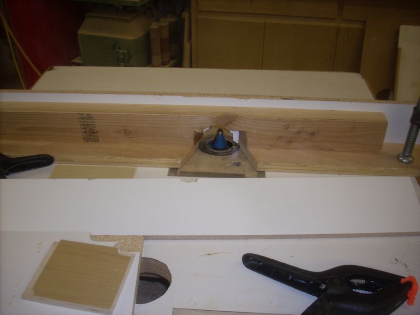

The rabbit cut on the insert is done on the router table.
Check the depth on a piece of scrap.

We made this router table and it is one of the most important pieces of equipment in the shop. (Even more important than my beloved edge sander.)
Here is a very important tip on the router table - the chips that come off of the router bit need someplace to go. Check out the cut out on the back of the fence. When we made this discovery, most of the routing issues we were seeing disappeared.
Also note the piece we clamp on to the face of the fence. This was essential on the little skinny ends that would otherwise have a tendency to dig into the gap that develops when larger bits are used.
